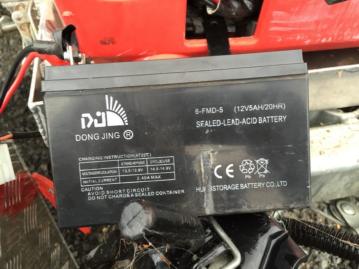

Can be fitted to handle, I also have an anderson plug connected so can be jumped. atm I start it with lipo jump starter. Unfortunately the lipo jump starters do not charge via the output alligator clips.

The battery in my genset is only 51mm wide, where most are around 65mm.
A "specially made" battery for $55!! This battery is L 150mm, W 51mm, and H 93 or 107 to top of terminals.
Thinking about how to get around this with maybe a cheap Lithium jump starter. Might burn the place down though.
Thoughts?

My first thought would be don't by a battery, fit a anderson plug to your gen set and just jump start it from the 2nd battery in the tow car or from the caravan house batteries.
I have my caravan fitted with a couple of anderson plugs, I can run a inverter from, the portable frig, charge the caravan house batteries up, run a 12 volt air compressor for example.

John, I can't find one 51mm wide

I do have an anderson plug connected to the genset so it can be jumped.
Vince said
09:30 PM Nov 8, 2016
Hi Paul
Found this that is near the size you are looking for.
which is 52mm -would that fit? or check some of the options on the website.
I would add a switch to isolate the battery from the genset after starting so it doesn't get charged.
Charge it with one of these https://hobbyking.com/en_us/imax-b6-ac-v2-charger-discharger-1-6-cells-genuine-au-plug.html
IMHO the motorcycle LiFePo4 batteries do not bode well in operation, they fail too early due to overcharging voltage.
Lead Acid motorcycle battery (or UPS battery) would be your best bet though, drop in -if you can find a fit

I bought a small 3AH 12V sealed batt for $20 from battery world for a mobile supply, tiny little thing should have enough guts to crank your genny, however it would need a charge each time.

Phil, would it charge from the genset like the original one does?

I think it should. If the old sealed batt did I recon the new one will. Depends on the charging system on board the genset. I would check that out first, like the delivered voltage and if its a constant current or constant voltage charger.
Thoughts?
www.batterydoctor.com.au/store/drypower-12v-7ah-narrow-terminal-sealed-lead-acid-high-rate-battery-for-standby-and-ups-replaces-hr1218w-hr1224w-lpl12-4-5-wp1224w-up-vwa1232p2.html

Thanks Vince. Now I have a backup plan.
Thanks everyone for your thoughts. No one was game to go down the Lithium path.
