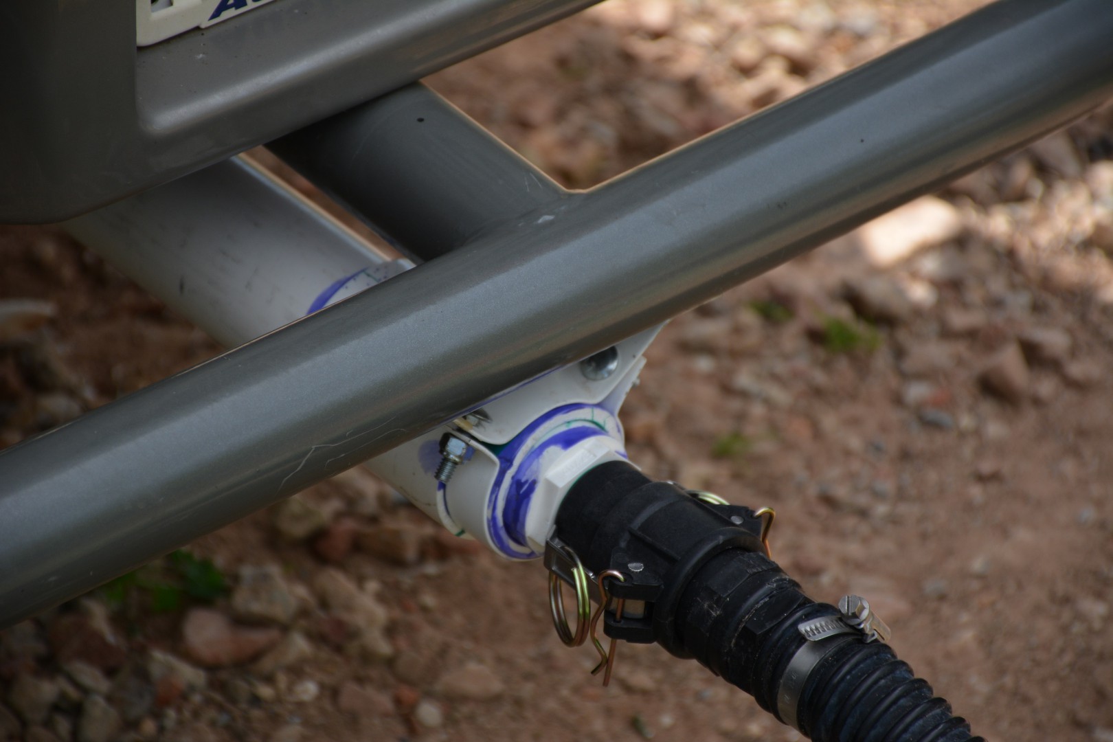

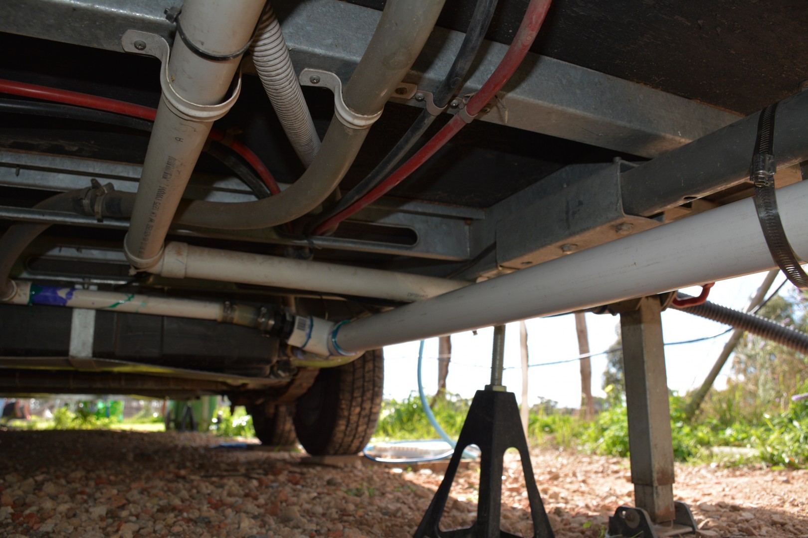

Welcome to the gang R and B, I did this.
1. 50mm heavy duty pipe. Joined the single pipe from the kitchen sink to the top of the 50mm then in the middle for the shower and bathroom sink
2. Washing machine has its own outlet
3. Quick connects used
4. Cost me about $100 and a bit of time on my back under the van.

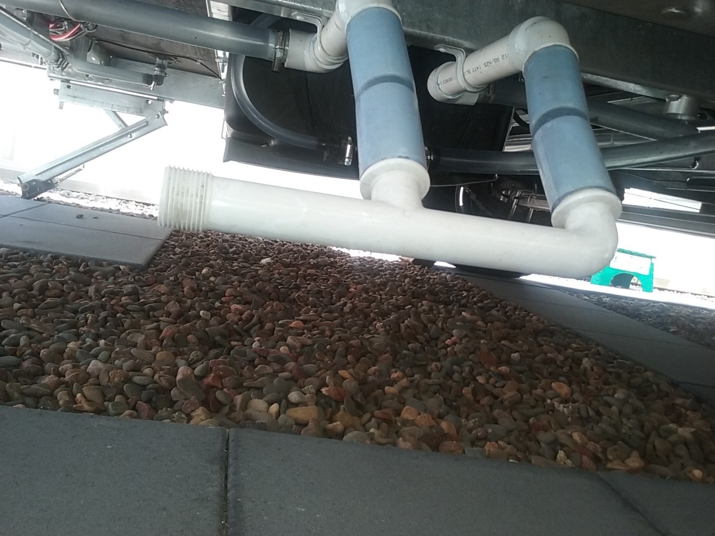

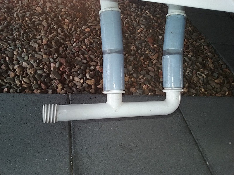

I have a recently new 16' Jayco Starcraft and when I first got the van I thought it would be a pain to use the plastic pieces as they were as I thought they would either have to be removed each time we moved or would be knocked off going over rises etc. if kept at the original length.
What I did was cut the plastic tubing off so that the 2 white plastic pieces were about 20-25mm apart when fitted together. I used boiling water to make the plastic pliable and also used some 'slippery' so they would slip on.
I will get a pic tomorrow and post to explain better, but have found the added height (drop) I now have is OK and the water drains OK from the shower, bathroom sink and kitchen sink. I only have to make sure the drain hose is level to the drain point. I thought the original length was way too low.
The pain I have now is that I have 2 drain hoses (short and long) and have to change the supplied Jayco fitting as required with a hose clamp. I'm happy with this arrangement at the moment, but I intend to do some further research to find some more compatible fitting as well, so will be interested to hear if you find anything in the meantime. If I find anything I will also let you know.
Another pain is that the washer in the screw on fitting keeps falling out when not fitted to the pipe.
Here's the photo
-- Edited by Peter and JudyH on Sunday 6th of November 2016 09:27:10 PM
Looking at the pic, its a bit deceptive as to how far its off the ground. At the height it is, I don't have any problem with back flow.
-- Edited by Peter and JudyH on Monday 7th of November 2016 08:50:46 AM
-- Edited by Peter and JudyH on Monday 7th of November 2016 11:18:42 AM

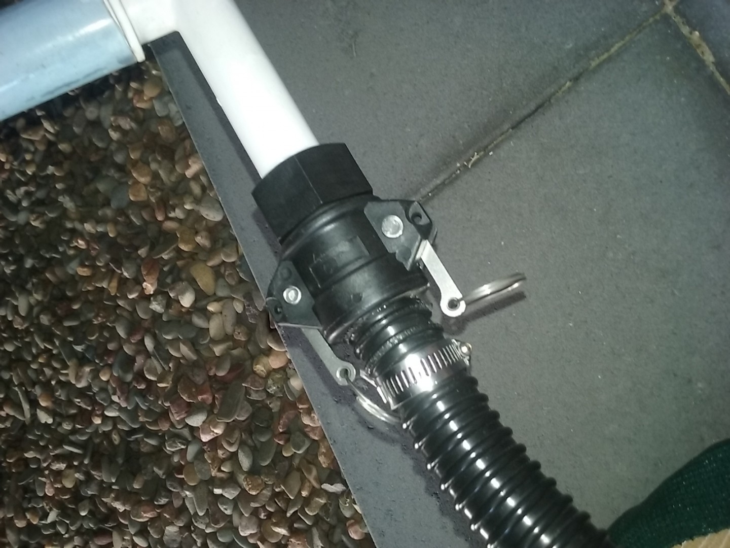

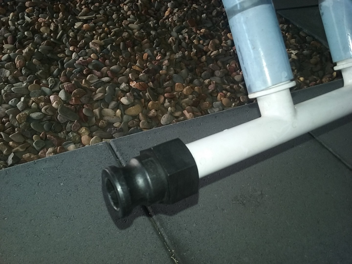

I took the start from what PhilC had done and have done a similar thing using male adaptor to fit to the outlet pipe and used a poly cam lock fitting.
I will leave the male adaptor on the outlet and just connect the cam lock with the hose when we park up.
Cost me $40 odd at our local pump/irrigation supplier, but I bought 2 of the cam locks - one each for the shorter and longer hoses. Cam locks are about $15.00 each

One of ours is from the kitchen sink and the other is the shower and bathroom sink. Washing machine on a different outlet.
Look, I know this may be an elephant to kill and ant and a lot of work installing etc. HOWEVER we live in the van and it is now able to deal with waste water clean and efficient.
Forgot to add.. Its real easy now to set up when we arrive someplace. No more bending to put those idiot pipes in place, just a quick connect and bingo.
