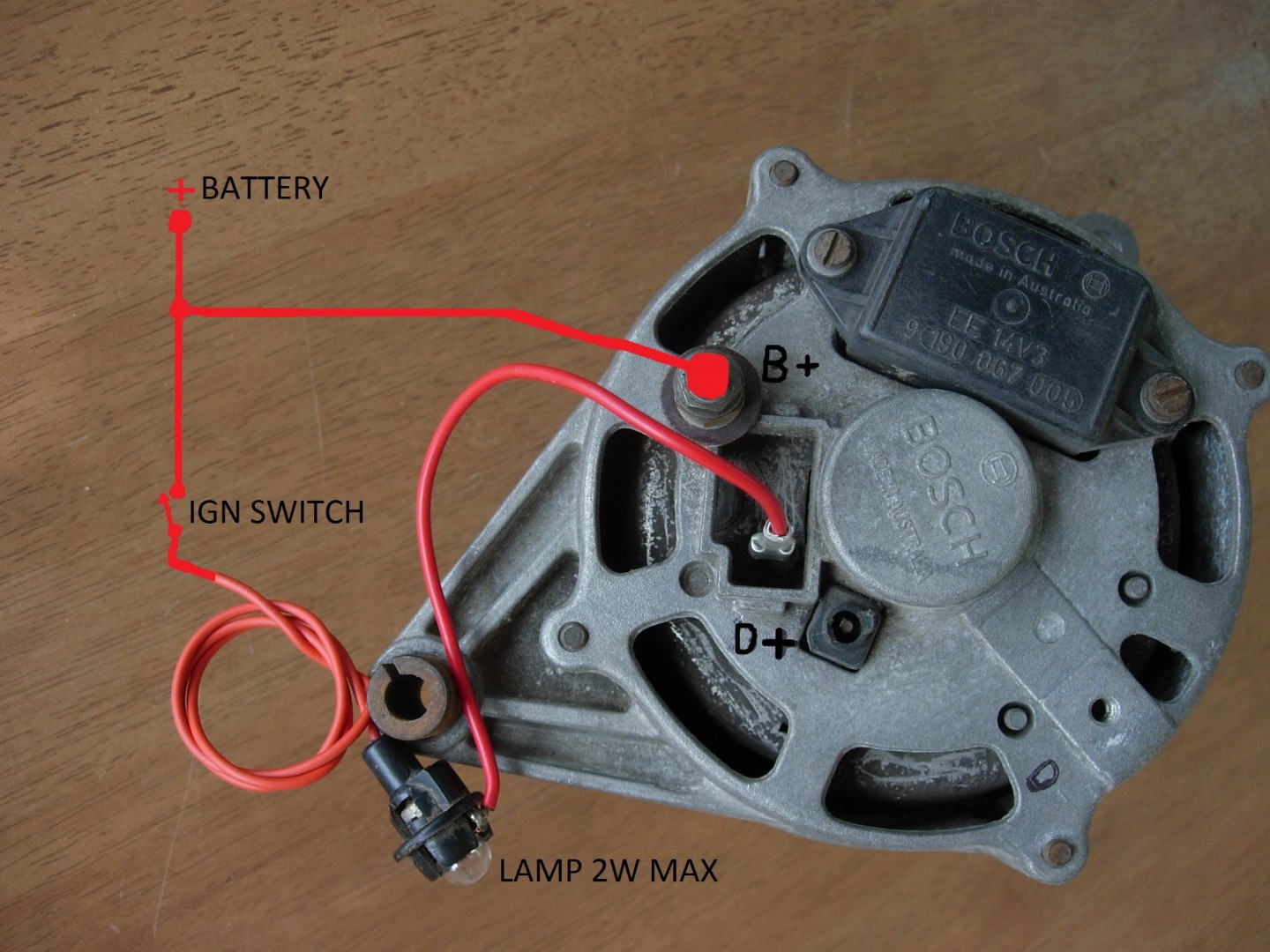

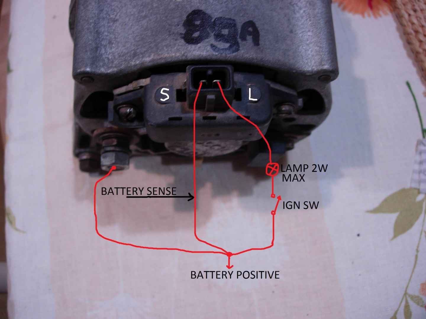

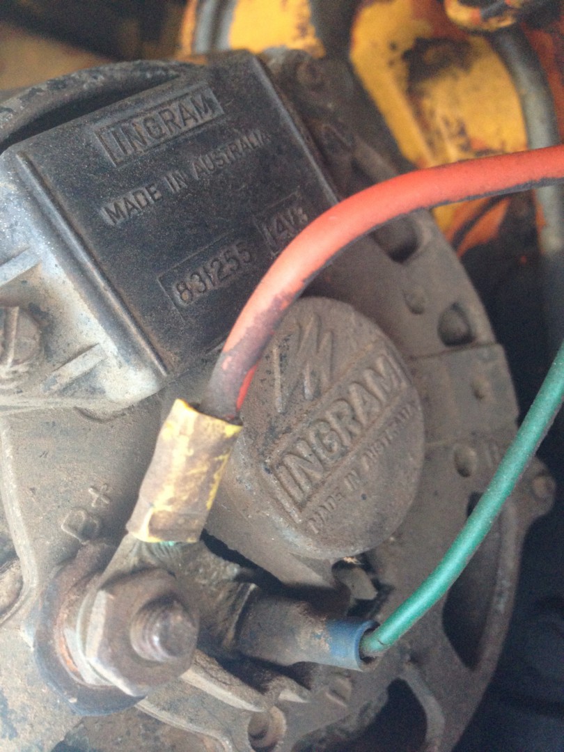

The alternator on my old Chamberlain 354 originally had an external regulator. After a recent flat battery on the old girl, I discovered a later model alternator (Bosch I think) with a regulator (Ingram) attached to the back. I checked the alternator output while it was running, no charge the reading was the battery voltage. According to the drawing the excitation was initiated from the oil pressure switch. Well my old girl has an oil line to the oil pressure gauge; i.e. no electrical terminals. I plan to fit a new 3 way ignition switch with a new warning lamp for the excitation circuit. The alternator only has two wires off the back, how is the excitation circuit completed. I researched a few drawings on the net which showed both sides of the circuit, however unsure on the correct connection. Any auto sparkies out there with some advice please.

I beg to differ on that I have one on my XF Ford panelvan. The main thing that will wear out is the brushes & they are easily replaced with out dismantling the altenator. A lot of later altenators have to be disassembled to replace the brushes. Those old altenators are very reliable.

what is the spare terminal next to the D+ terminal in the photo?
Thanks
Oldgrey52
DeBe said
01:08 PM Nov 5, 2016
The spare terminal is a 7V feed for automatic choke, just disregard it.
ISTR that some alternators had an extra terminal for controlling an electric fuel pump. If the alternator stopped turning, the fuel pump would cut out. Could that be another function of the 7V+ terminal?

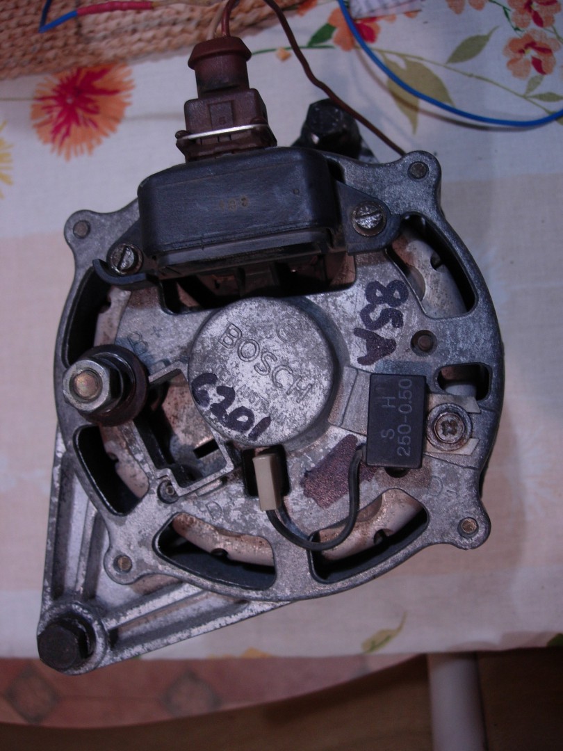

This is a very common 2wire Bosch altenator on Fords & Holdens. Ingram regulators are after market reg.
Correction, the alternator is an Ingram, please see attached photo. So the D+ will be my connection to the new warning lamp on the dash?

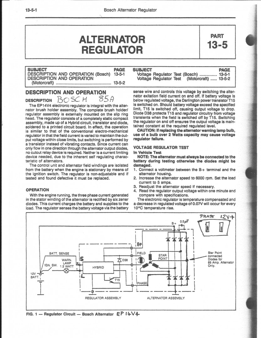

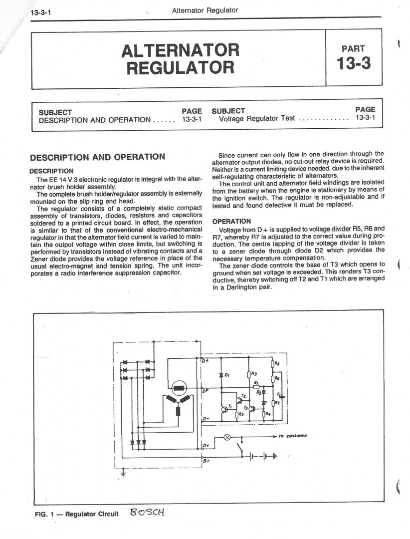

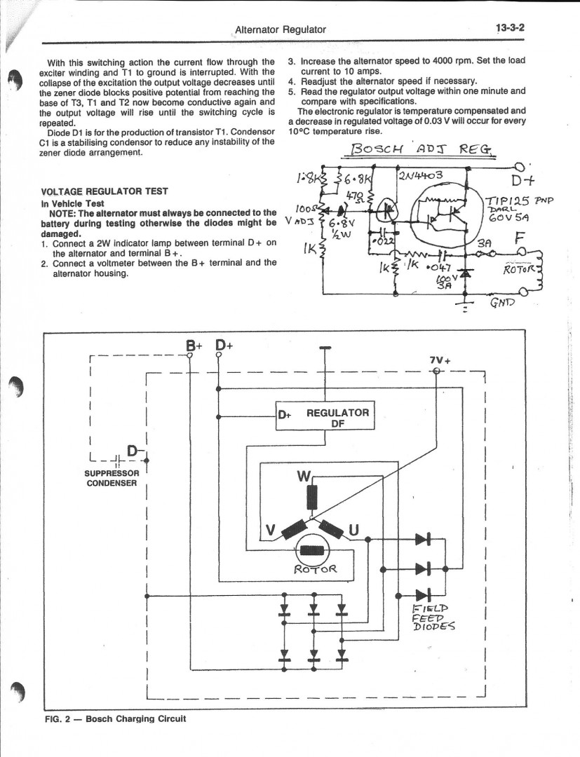

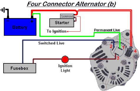

Heres the circuit of the altenator & description.
Thanks DeBe.
Oldgrey52
