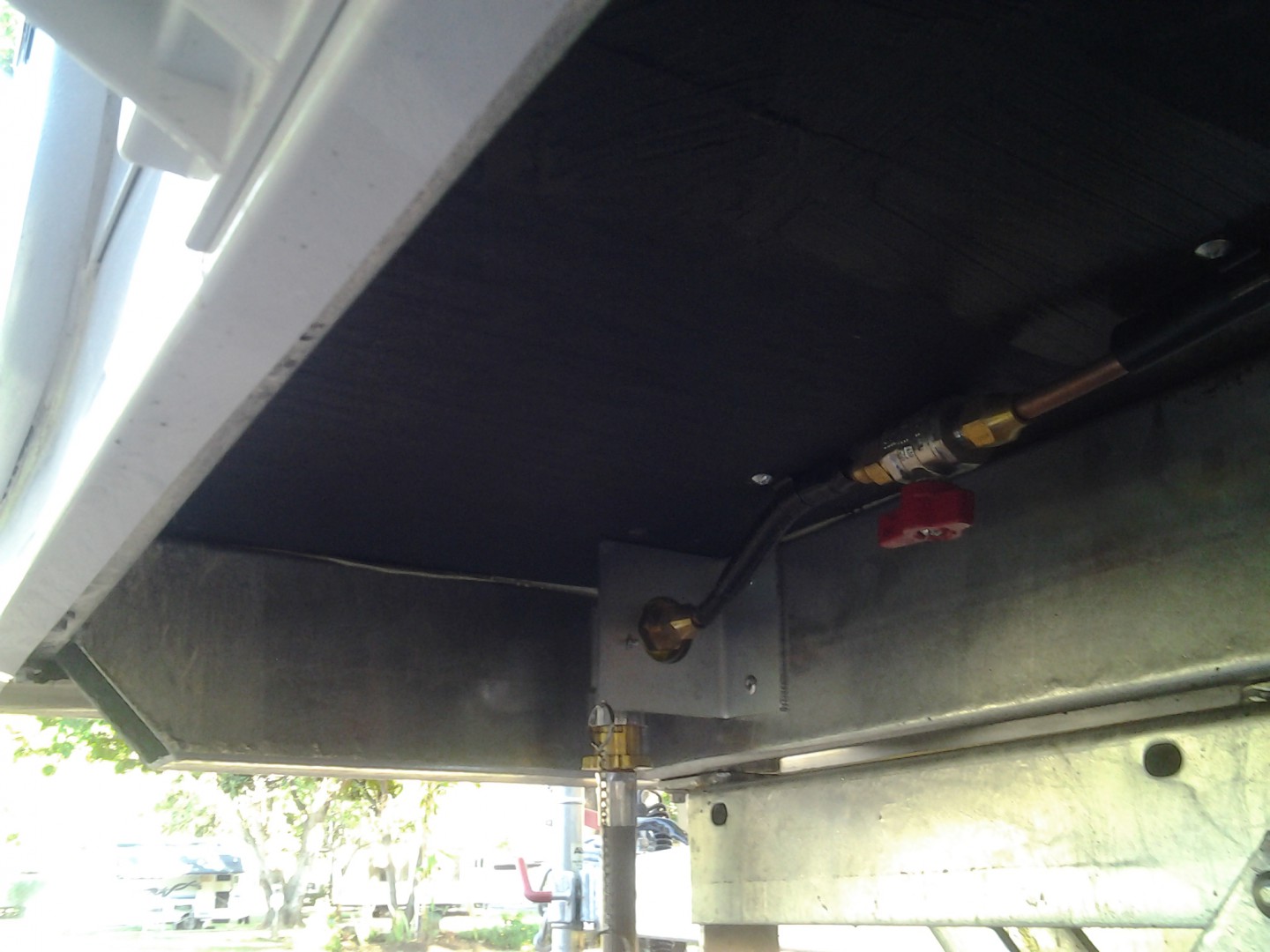

2. When i want to connect the webber to the outdoor gas conection I have tot lay down on the ground and push firmly the conection piece in as Jayco have placed the connector on a chasis beam for a firm mounting. Usually thats ok, but this trip it has been wet and muddy.....getting soft in my old age. Has anyone redirected the connection so its easy to just bend down rather than having to lie down and crawl under?

Re no 2 - Have excatly the same problem and will be investigating at first opportunity if there is a fitting that can be set somewhere near the cylinders or on the towbar somewhere.
I was thinking a male to male extension left permantly in outlet and attached to towbar/bracket near cylinders?
I will be interested to see if other Jayco owners have a suggested solution

As to your gas connection - probably a bayonet? Have it moved 20mm in from flush to the outside wall on your van.
That's where ours is, behind the jacking bracket with an aluminium protective cover easy to get to and haven't had it damaged yet.

yes female bayonet on van. Its under front LH side near front of support leg

Yep, re-route the gas piping from the shut-off valve to the outer edge of the near side support leg and instead of the fitting hanging down turn it 90 deg level and facing rear then rivet a cover on to protect it.
A plumber could do it for less than a van repair shop as that is who I used after a hexy quote from repairer.

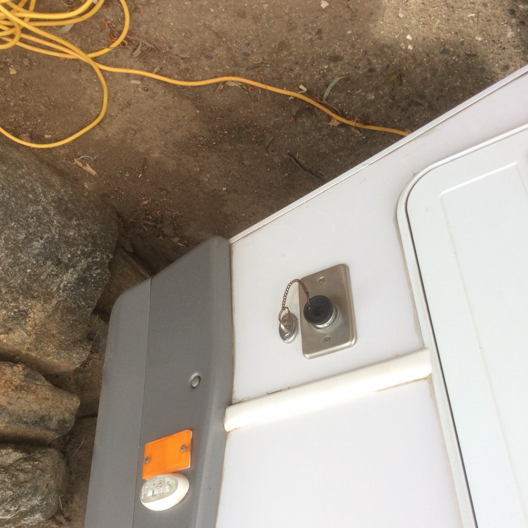

Re question 2, Jayco initially installed mine as you indicated but I wouldn't take delivery until they put something more sensible in. This is what they did and it works well.
edited to ask why it always posts photos upside down when they're not upside down before posting.
-- Edited by Conquester on Thursday 27th of October 2016 08:56:35 AM
