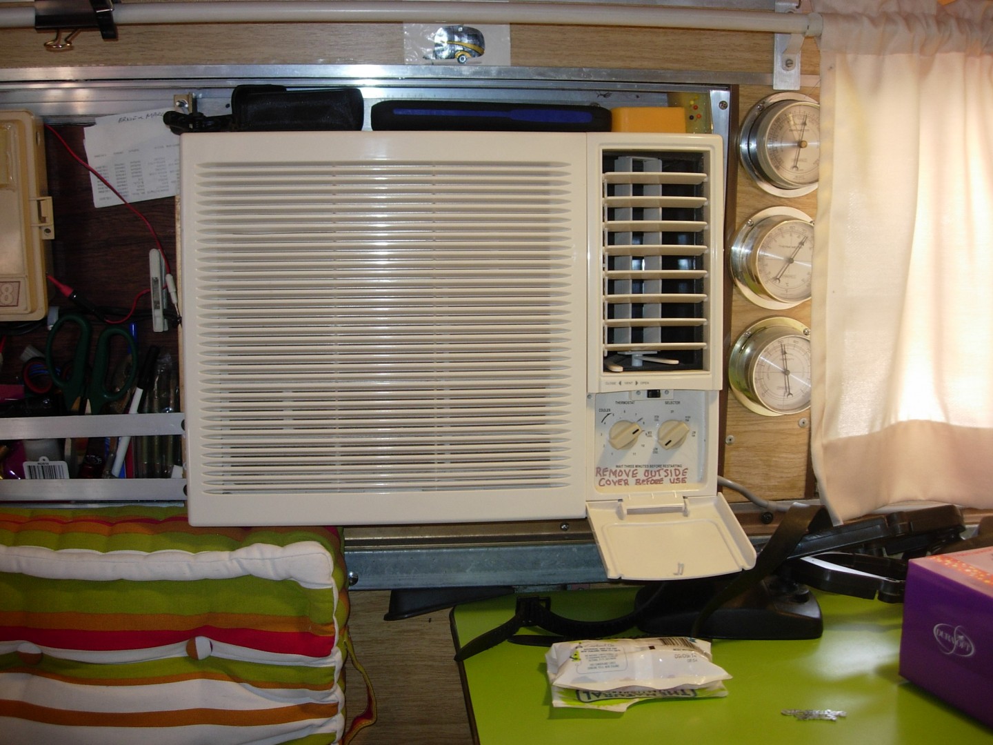

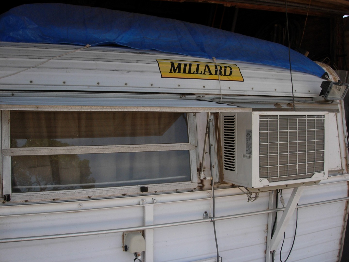

Portable refrigerated airconditioners are not very efficient. I fited a small aircon in one of the front windows of my small 12Ft van. It works great even in the high 40s, & will run of a 1Kv generator.

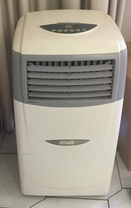

Anyone have experience with a portable air con
Our van is only small 16ft golf
Down South Evap cooler fine.
Up North Proper Air conds only.
Most just use a fan and have door open.
with that size van.
Mobiles start around $350 and go up.
