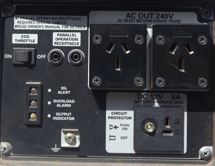

I inherited a Honda Eu20i Generator, when I purchased my second hand RV My roof top air conditioner is a Coleman Mach
My generator will work the air conditioner, with no other 240 volt appliances switched on
I was advised, and the few times I have used the generator, I follow this procedure
Start the generator with the economy switch OFF, (to allow the generator to reach high revs)
Start the (whatever 240 volt appliance you are using)
Switch the economy switch to ON, (to allow the revs to come down, lower the noise, and use less petrol)
The idea behind this procedure, is that most 240 volt appliances use more power on start up, than when running
This seems to work for me

Tony Bev said
06:09 PM Oct 18, 2016
Dougwe wrote:
How, Tony, I am not being a smart a..e but for mine and others info and might also help Anne with her question....how does your gene behave as it cuts off then soon after back on etc while the 'eco' switch is on ?? I usually need it off.
Just for further reference and taking in consideration that Anne is new here, this sort of question would be much better in the 'Techies' section.
Hello Doug
Usual disclaimer that I do not have the same natural abilities, as a real scribe, and sometimes I can even confuse myself, after reading my own writing I can assure you that I would be one the last persons on this forum, to think that any of the long term members, were being a smarty pants
I have just double checked that what I had written was correct
It is the Honda Eu20i generator, (red on the side, and black at the ends)
What I called the economy switch, Honda call the Eco Throttle (see picture)
With the Eco Throttle OFF, my generator stays on high revs, regardless if it is being used, or not being used
After switching my air conditioner on (Coleman Mach is the only info I can see, as I have no paperwork for it), and leaving it on for a few minutes, I switch the Eco Throttle ON
Perhaps it is my brand of air conditioner, but when I switch the Eco Throttle ON, I can hear the revs drop by about 10 to 20% I will assume that the generator is now only supplying the amount of power which is being drawn from it
The picture shows the Eco Throttle ON, as after disconnection the 240 volt appliance, I like to let the generator idle for a few minutes before switching it off

Tony Bev said
03:06 PM Oct 20, 2016
I have tried to edit my posts concerning the Eco Throttle on my Honda Eu20i but for whatever reason, they appear to have been lost in cyberspace about two hours ago
From practical experience running my Coleman Mach air conditioner for 4 hours, with the Eco Throttle switch ON, I had no problems I was actually trying to charge my house battery through the built in SETEC power supply, and ran the air conditioner just because the generator was running Perhaps my air conditioner does not cycle off
But... From correspondence with Doug, and his explanation of his practical experience, of having the same type generator stall or stop when his air conditioner cycled off and then on again
I have now looked at the manual
On page 12 it says to have the Eco Throttle switch ON, to save fuel
But...But...It also says further down the same page
Eco Throttle system does not operate sufficiently if the electrical appliances requires the momentary electric power When high electrical load appliances is connected simultaneously, turn the Eco Throttle switch to the OFF position to reduce voltage change
I take the above to read that we should have the Eco Throttle switch OFF, when using high loads such as air conditioners which cycle on and off
I hope that this explanation may help to avoid any confusion

Dickodownunder said
10:49 AM Oct 21, 2016
I have a Honda EU20i.
I dont have the manual with me at the moment but I am sure it says in there not to use the ECO switch if you sre using the attachment cable to directly charge a battery.
The dealer from where I bought mine also told me the same thing.
I have used mine to charge the extra battery in the wagon and it runs harder, a bit louder, and uses more fuel with the switch off.
I guess that is why it is called Eco Throttle :)
Hope this info was helpful to you
I hope that this has cleared up any confusion
But...
