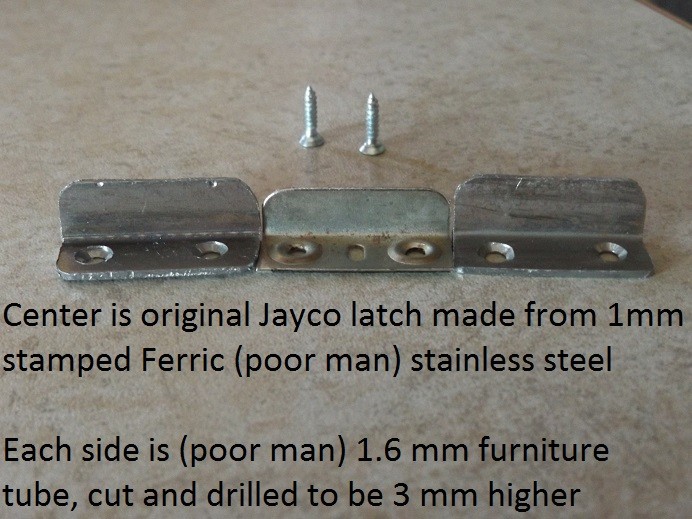

This first picture is an original draw latch, with two home made ones, 3 mm higher next to it Although the home made ones are only made from an old 19mm square 1.6 mm thick chair leg The overall short measurement of 30 mm long with sides of 13 mm makes it too hard for me to bend They should be suitable for keeping the draw closed, if the draw has sagged

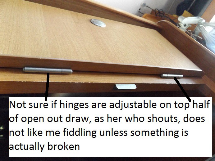

This third picture, tells the story of a frustrated fiddler
