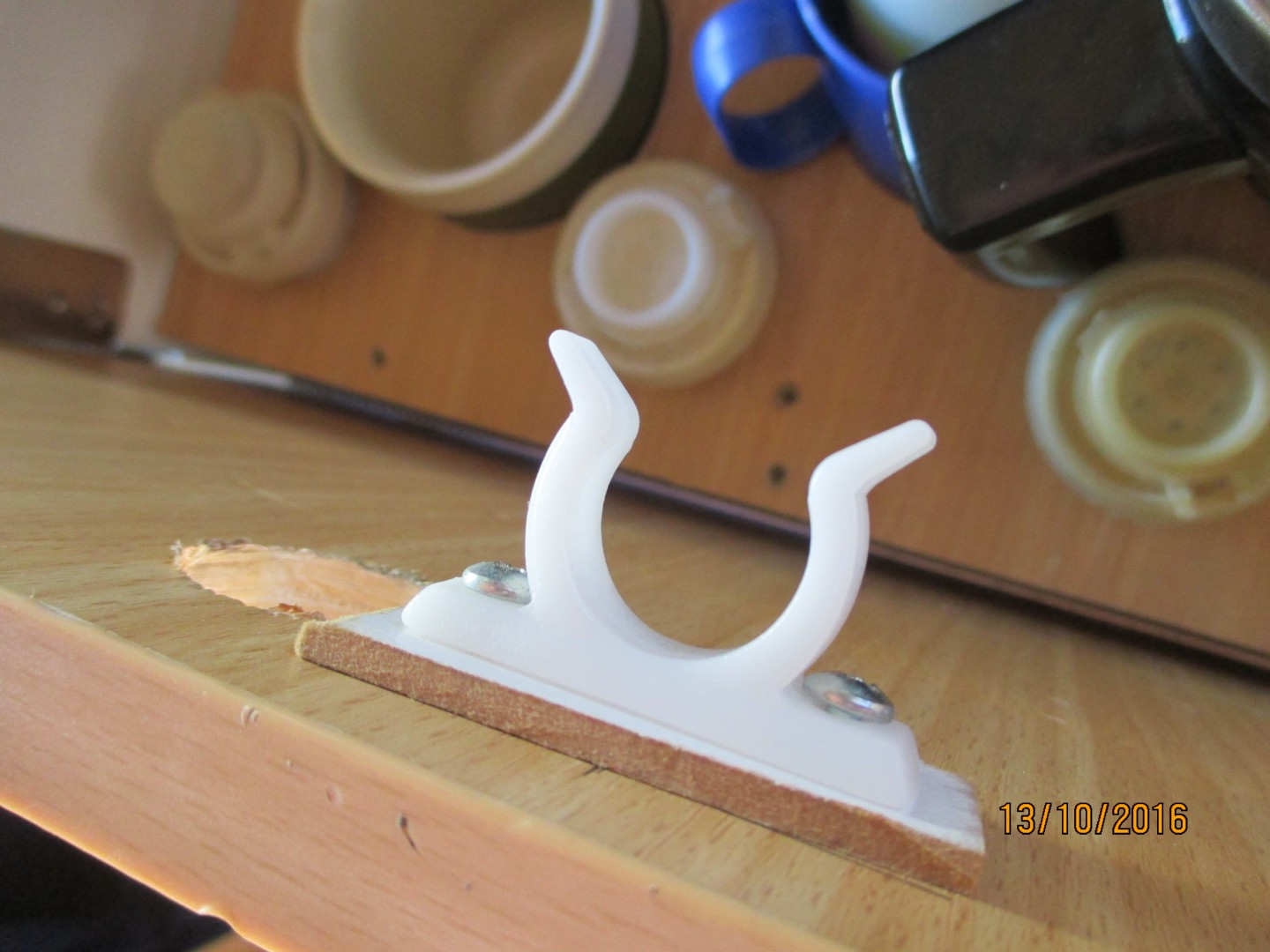

I fixed the overhead latches from opening by themselves when cornering by extending the catch first by replacing the metal bracket with a longer (higher) L shaped bracket then tried packing under the metal part sometimes successful, sometimes not.

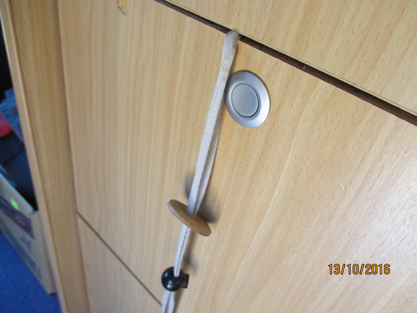

Drawers were another problem. I replaced one broken lock with a cupboard "U" catch but the constant movement sees me constantly tightening the screw which now has been replaced with a bolt. Still not 100% satisfactory, so I found a couple of bottle caps into which I drilled a hole then using a bootlace and the cap that seemed to work but now I have replaced the bottle cap with a 3-ply disc, shoelace and toggle (from a hat).
Unless the pre-flight check fails, this seems to work effectively but is a little untidy.

BazzMann48 said
11:25 PM Oct 13, 2016
Here we see the boot lace, 3 ply disc and toggle. Reasonably effective. The boot lace is looped over the timber cross member.
