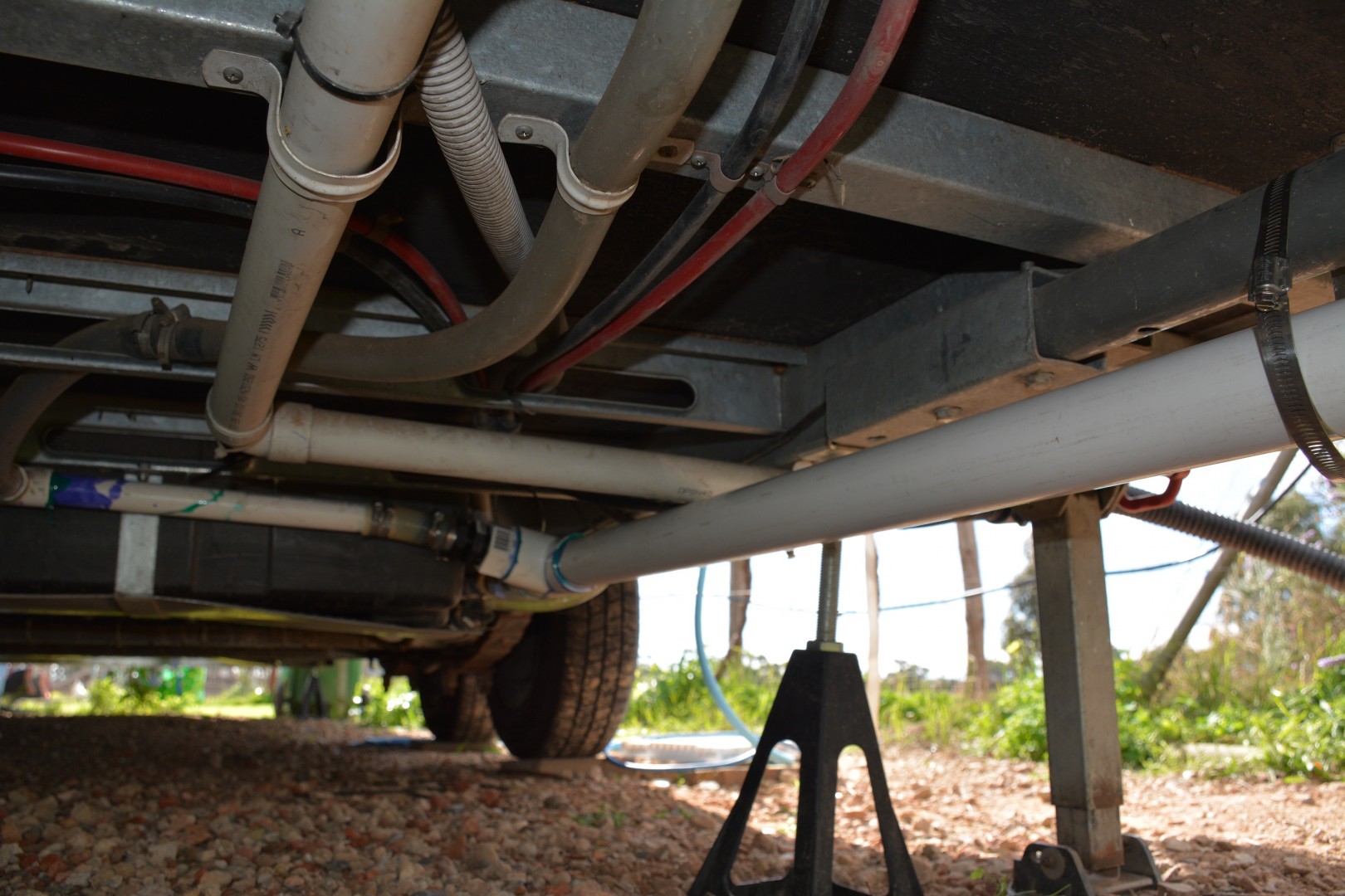

This is what I have done to our Jayco. Works a treat.
I guess Jayco owners with new vans don't have this system. I just wondered what others had done, buying a length of 40mm dia. water hose is the easyest option.
Its funny because when we brought the van we were recommended to have the spare wheel fitted under the rear at the back, which is a real bastard to get out, and have a tray fitted in the "A" frame to carry the waste hoses. Now I know the real reason.

Ian, don't be fooled by all those pipes under Phil's van mate They are really to transport his wine from one end to the other

Looks to me as though Phil has reduced the 40mm down to 25. If that's from the washing machine, I hope it drains well, or else he may be in the bad books with the Mrs, if its the stack pipe like in our van.
03:18 PM Oct 2, 2016
A few MM undersize over 100mm will hardly make any difference . Especially if it's lower than pump ..

Don't think I would want a drop of red from those pipes! could give you more than a headache. Looks to me as though Phil has reduced the 40mm down to 25. If that's from the washing machine, I hope it drains well, or else he may be in the bad books with the Mrs, if its the stack pipe like in our van.
No Iana, its me being lazy and not removing the 25mm pipes yet. The whole show will eventually go into the 50mm pipe and out the back. Works a treat so far.. Hey Dougwe, not a bad idea for the reds, but the pipes would need a good clean and the wine would get a good stir the way we travel...
