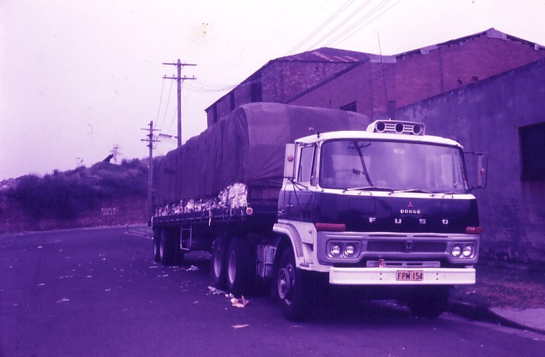

Back around 1976 to 1980 we owned a Dodge Fuso prime mover, it had a hip cup with the electrics and took it into a auto elects, a brute bloke, he was a bit of a legend, he told me that the 24 volt electrics were one of the best he had seen and worked with in that truck. My memory is not clear what happen to the charging system pretty sure it was minor while apart threw a couple of bearing in, he said it would be cheap insurance. Nice system.

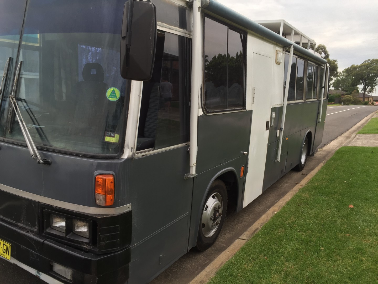

Yes they are designed to be fixed quick and very durable being a bus originally . It did have a 2litre Sigma motor to run AC . Which was removed . Only removed Alterater to fabricate better inlet to turbo . Plastic induction is not long lasting . Stainless and silicon joints now . The weight of alternater would be similar to Ecoboost 1000cc 3cyl engine . Nearly required engine crane to remove .

Our bus .painting lower grey with maybe another highlight colour? So its a little camoflaged free camping .
there was quite a few UFO's around this time (unhappy fuso owners) I take it you were not one

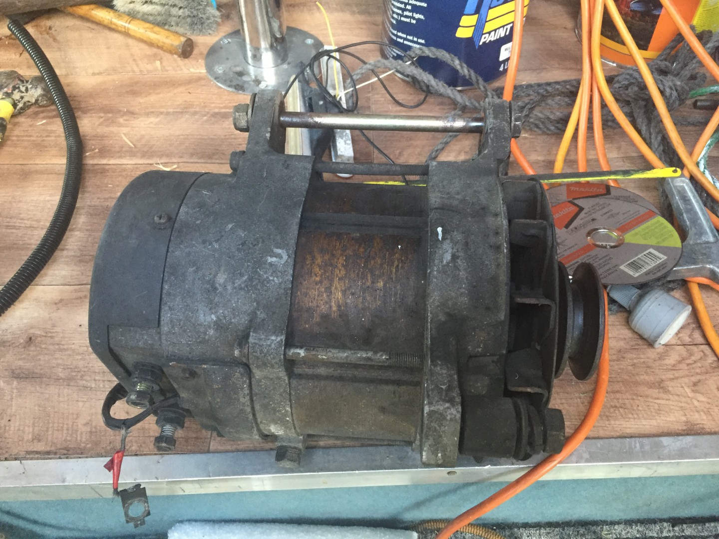

Rang my auto elect guy if it would be advisable to fit bearings etc . He asked how many klrs ? Said they'll do 800,000 easy being brushless . Said if it's smooth on bearings it'll be fine . So I lubed bearings . All good . What a pita fitting it back in ! Aligning bottom bolt .. Ended up fitting tension bracket to align . A wiggle .. Bam done . Man these things are HEAVY !! Designed for durability !!

It's an industrial engine etc brakes are massive being a bus . Front brakes same size as rear . Tell ya with weight of things you have to use your smarts and patience !! Being elect fitter / lineworker in past helps .. Then I think what I have to pay to get someone to do it ? Then I'm happy to do it myself ! lol

120 amp 24 volt brushless alternater out of my old Fuso motorhome bus . Weighs a heap too !! Charges house batteries as well .
