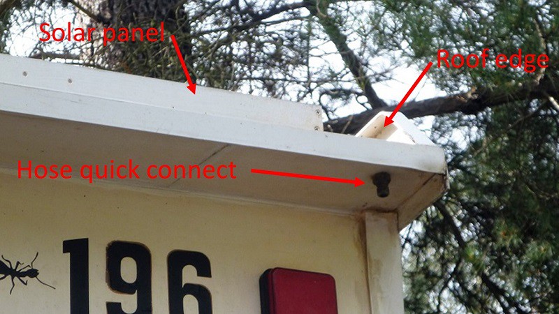

The OKA has a flat roof. The sides and front have a 75mm high edge (there are drains in the 2 front corners). The rear has an edge of about 3mm high and a hose quick connect in each rear corner. If we want to collect water, we park with the back lower than the front. Connecting a hose to the lower of the back corners and to the tank inlet directs all the rain from the roof to the selected water tank.

Just lower back of van a little with jacks when raining.
You'll find a LOT of water runs off those two corners.
Just put buckets under and catch it that way.
No hassles.
Works a treat.
No hassles.
