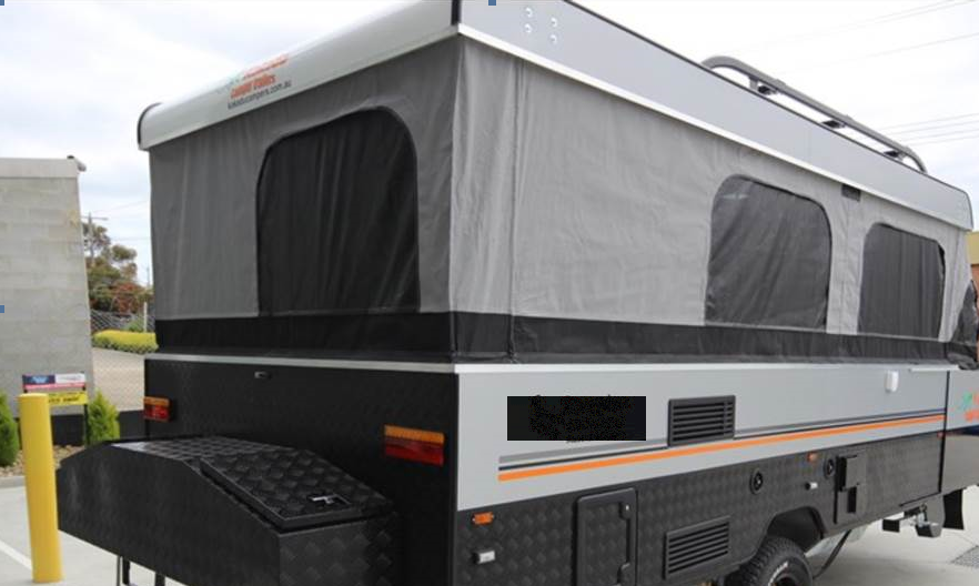

Anyone had experiences with roof top air cons on pop up vans (half hard body half canvas) Pro's & Con's plus a suitable genset that will handle the AC output? I'm in a warm top end climate and need decent cooling (Due to a Spinal injury), the van I'm looking at advertises an "Aircommand sparrow" however after giving dimension's and photos to a AC "guru" they suggest a larger unit Truma Aventa Comfort.
The roof on the van is a hydraulic lift so not manual handling required, has approximately 200kg limit.
The sparrow will run from a Honda EU2, they suggest the same genny may run the Truma if in good new condition..
What to do!
Van dimensions Approx 5.5m long fully extended Approx 195cm high Approx. 2.1m wide

The van has four hydraulic Rams 1 in each corner so no manual lifting required, the roofs rated to carry around the 40Kg mark for a AC unit, I'm looking at a Aircommand Truma its output is slightly higher for the 2+kv mark. I just don't have any experience with vans with canvas and AC's, will it keep us cool in 30-35 deg days (worse case)?
