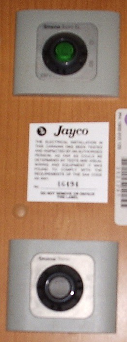

Ours is a model Truma B 14 In the picture below The lower switch is for the gas operation with three positions 70 degrees, off, or 60 degrees The upper switch is for the 240 volt, which can be either on, or off

Tony - in our MH there is only the bottom switch as per your photo.

Hello FraLyn
I am not an electrician and my model may not be the same as yours
You mention that you do not have a switch to switch from gas to 240 VAC
