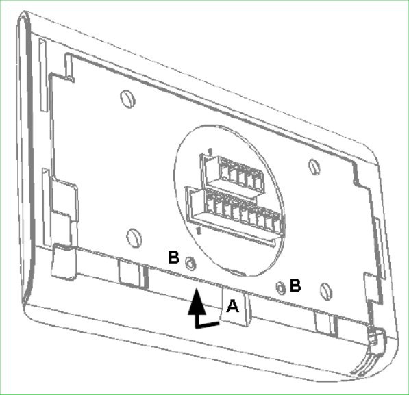

We are in Sandstone WA.Our water pump switch on our Drifter house Monitor is Stuffed on our maiden trip.
The pump will work only if I hold the hardest plugs X 2 at the rear in the cuboard in our Jayco Journey Outback.
I need to remove the unit total to try and fix the 2 clip in plugs behind.
I cannot see any screws holding it in from the rear. Can anyone tell me if the face clips off, or can the unit pull straight out from the front as it too is loose to the veneer timber surface.
Jim & Lambie
iana said
11:32 PM Sep 4, 2016
Insert flat-blade screwdriver into slot 'A'. Gently lever case away from bracket enough for dimples 'B' to clear locating holes Then slide Drifter upwards. Note: Some force may be needed to slide the Drifter upwards because it usually binds tightly on the four locating tangs
-- Edited by iana on Sunday 4th of September 2016 11:38:12 PM
Yes I found the book in my nightmere of booklets. I didn't need a screw driver, it slid up without the need of one.
I have put sum Blue tack in and around to try hold it in place.
We have had doors come off, 240 volt issues with poor politely. Not happy.
thanks again. Jim

Hi All,
Jim & Lambie
Hi Iana,
Thanks for your quick reply.
thanks again. Jim
