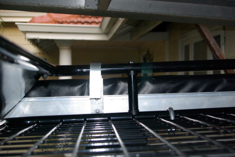

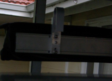

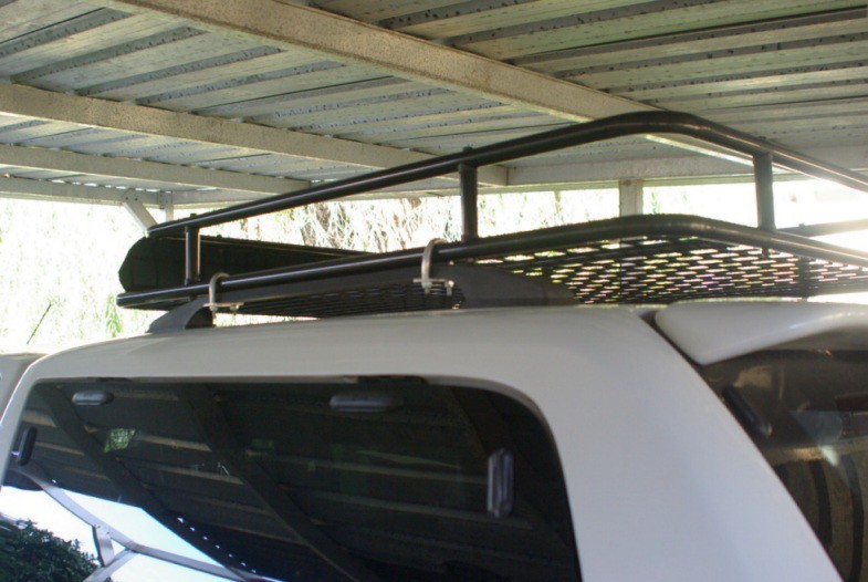

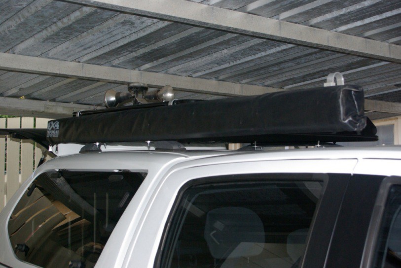

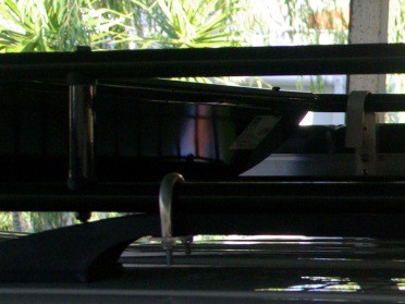

Here you go then. The u bolts are M6 all thread with Aluminium covers, with a 3mm Aluminium pressure plate and nyloks. All of the fittings provided assumed you had cross bars, but the basket just fitted onto the rails.
There are three deep hooks on the awning - the centre one set a little higher than the end ones to offset somewhat the downward direction of the roof basket. To position the awning the middle hook goes near the front of the basket and the required back hook near the back of the basket. Again the original fittings assumed that the spacers between the basket bottom and top were solid plate and could be drilled through, whereas on this basket they are hollow tube with a bolt through and cannot be drilled through. By having three hooks and using two to fit it can be hung on either side. The awning is stored in the ute canopy when not being used. I just need to add either some pipe insulation to the hooks or a split plastic pipe over the top rail to stop scratching and also paint the U bolts black to match the basket.
