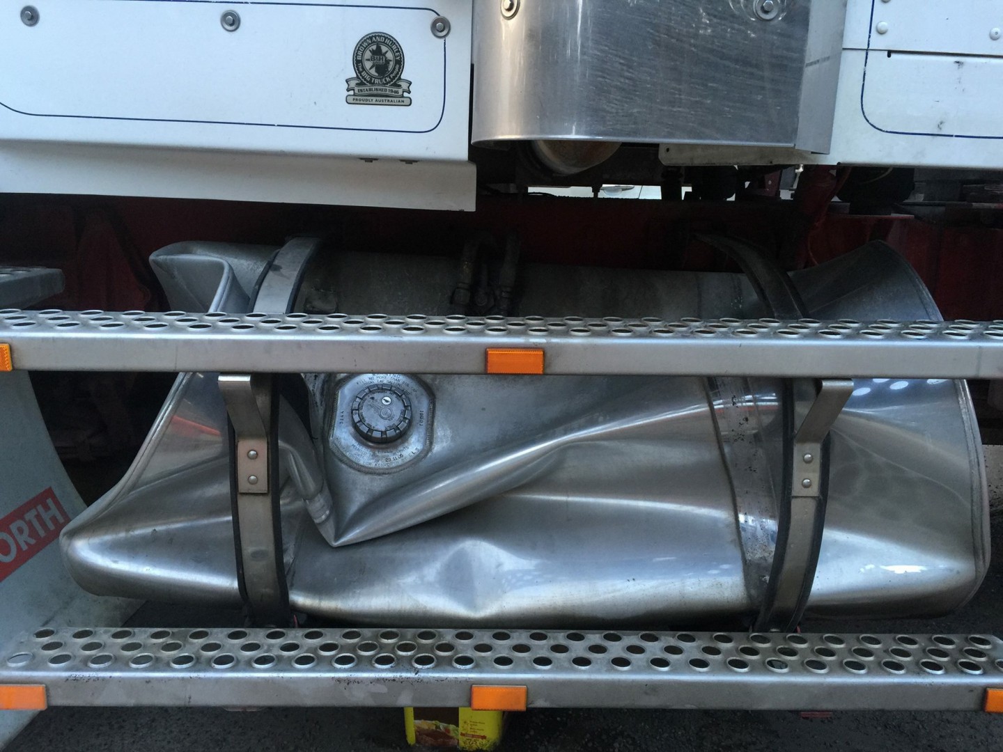

iana said
11:09 PM Sep 7, 2016
Interesting picture of an unvented tank, guess the driver was sucked in!
