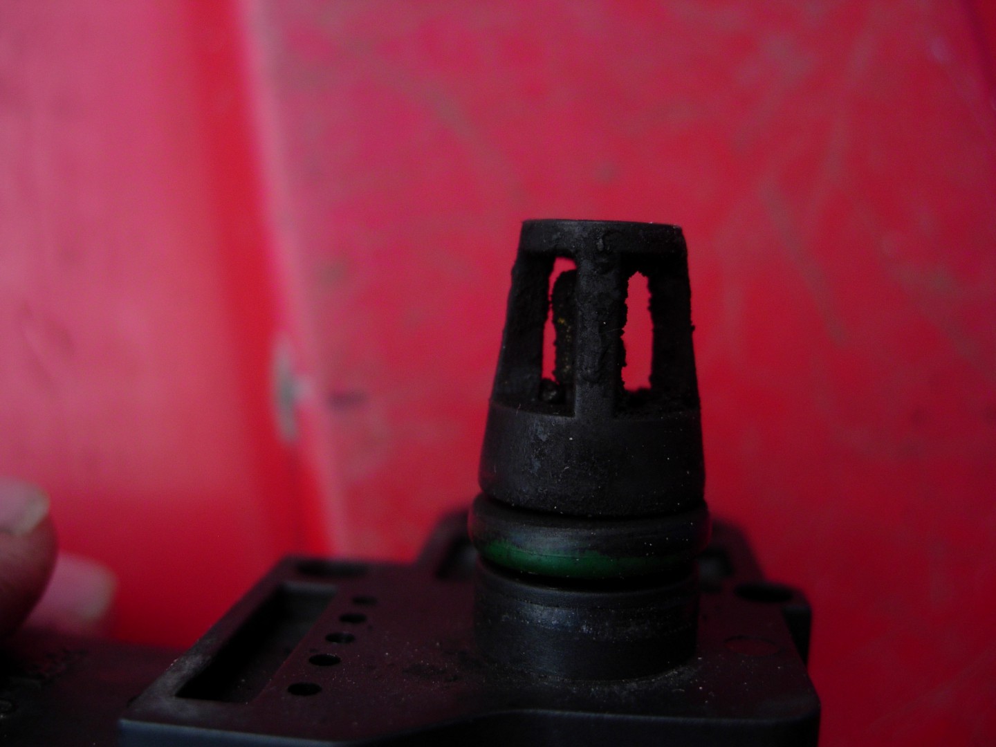

DeBe said
03:56 PM Aug 28, 2016
This is out of a Ford ranger diesel MAP sensor. Carbon baked on & this is as good as it could be cleaned using various sprays. A new one was fitted, the customer did not want any thing else done. So have no idea what the rest of the inlet system was like.
My V8 70 series has had a blank-off plate with a 8mm hole since new also a Provent 200 catch can (it traps about 100 ml of oil every 5K) , at 90K I checked EGR blank 0ff plate and found about 30 grams of carbon, have now updated ECU to disable EGR valve altogether. (illegal)
All up the catch can (provided it will carry the full vapour load of the crankcase "min of 19mm hoses" ) will reduce the amount of oil ingested by your engine. As it is a closed circuit it should not contravene any anti pollution laws. (return vapors to inlet manifold minus condensed oil.) MAP sensors should be upstream of EGR reintroduction of burnt gasses on most vehicles, I admit I have no experience with particulate filtration systems however.
