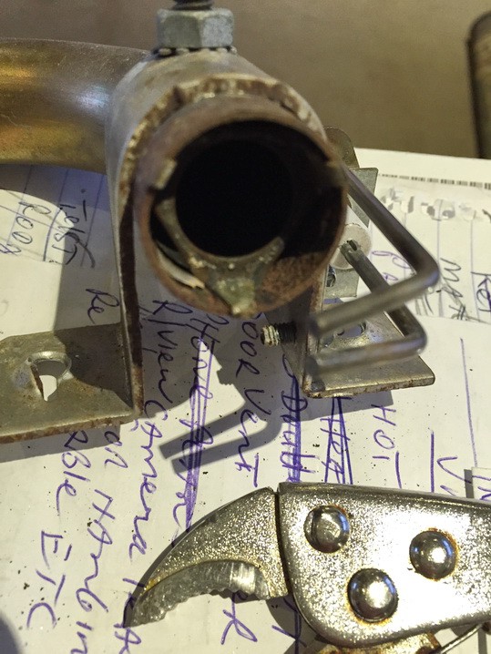

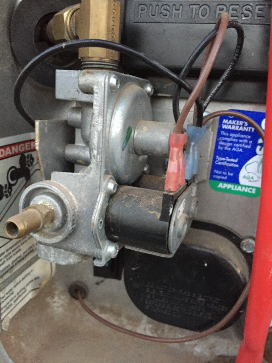

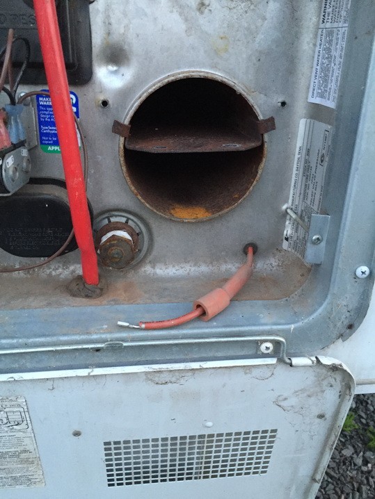

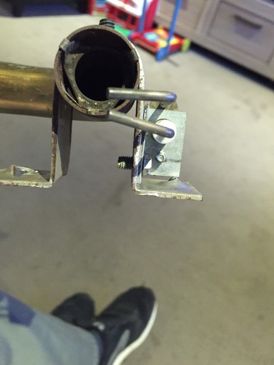

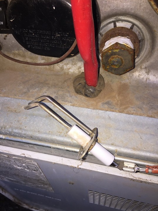

Some pics to show what I actually have. I imagine that the igniter also controls the gas shut off even though it is not right in the flame. Am I correct or not?
-- Edited by aussie_paul on Thursday 18th of August 2016 10:07:07 PM
-- Edited by aussie_paul on Thursday 18th of August 2016 10:08:44 PM
Today I put a volt meter on the igniter while I held it over the kitchen gas hob. There was some BUT very little voltage but as soon as I took it out of the gas flame the voltage disappeared. So I ever so slightly bent the two probes of the igniter more into the flame. It took a couple of cycles to get rid of the airt and then kept going. So, fingers crossed.
