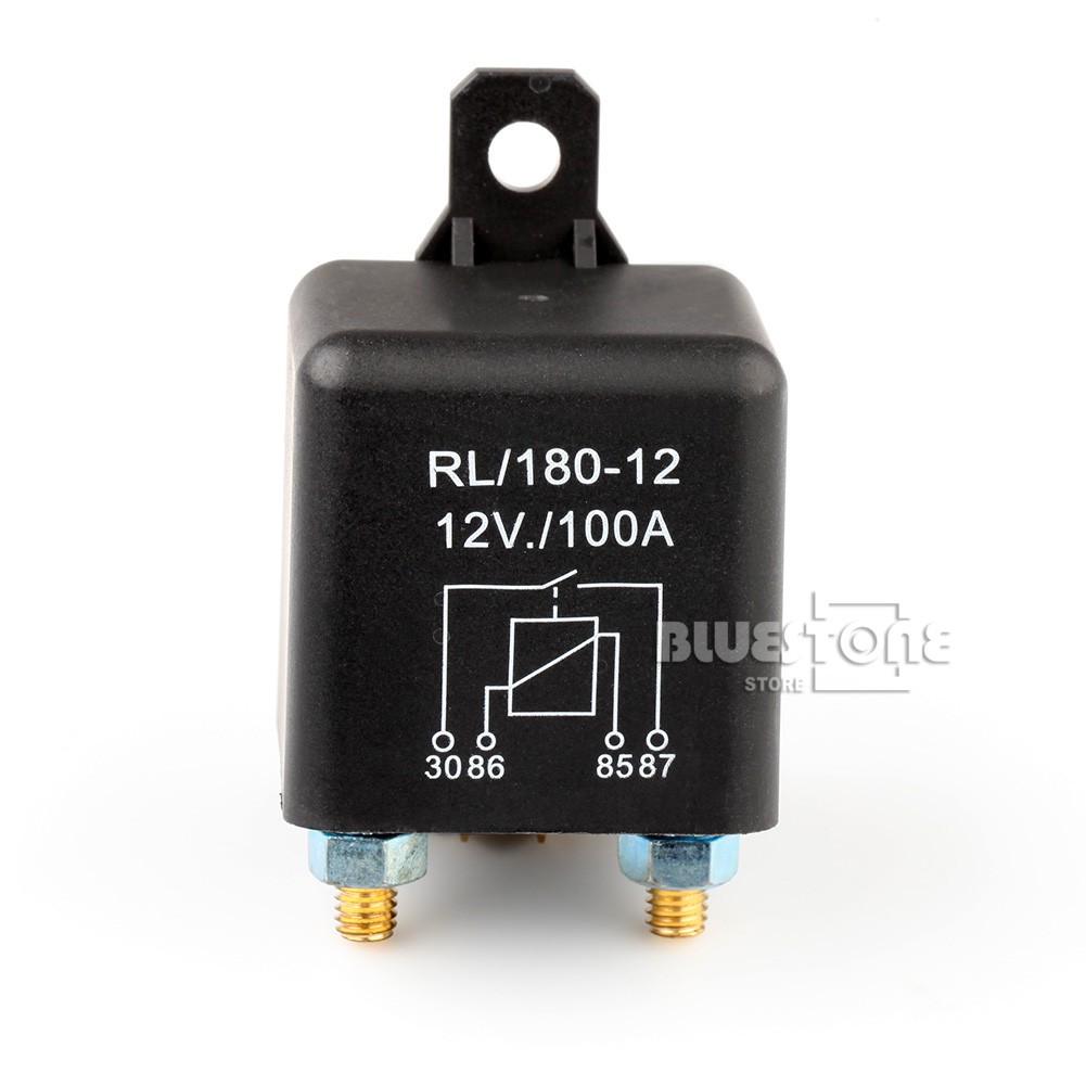

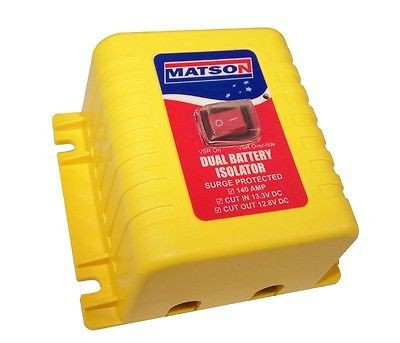

I would recommend a 50A fuse and 100-150A Dual VSR (Dual Battery System Voltage Sensitive Relay) for the battery charging. I would recommend a 50A fuse and 12v 100A Relay Switch for the 12v fridge power. Photos are a guide only.
Both of the above will not allow your vehicle battery to go flat when you turn off the ignition and will automatically activate when you start the engine. Safest way to go. You can buy all the bits including cabling on Ebay or Aussie online sellers. Of course connect via Anderson plugs.
