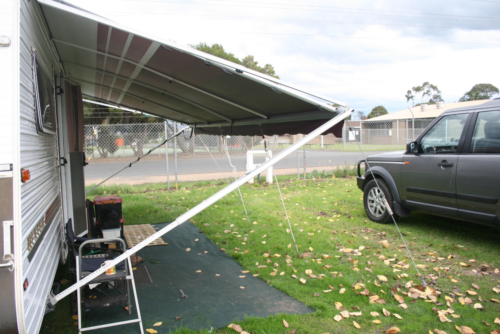

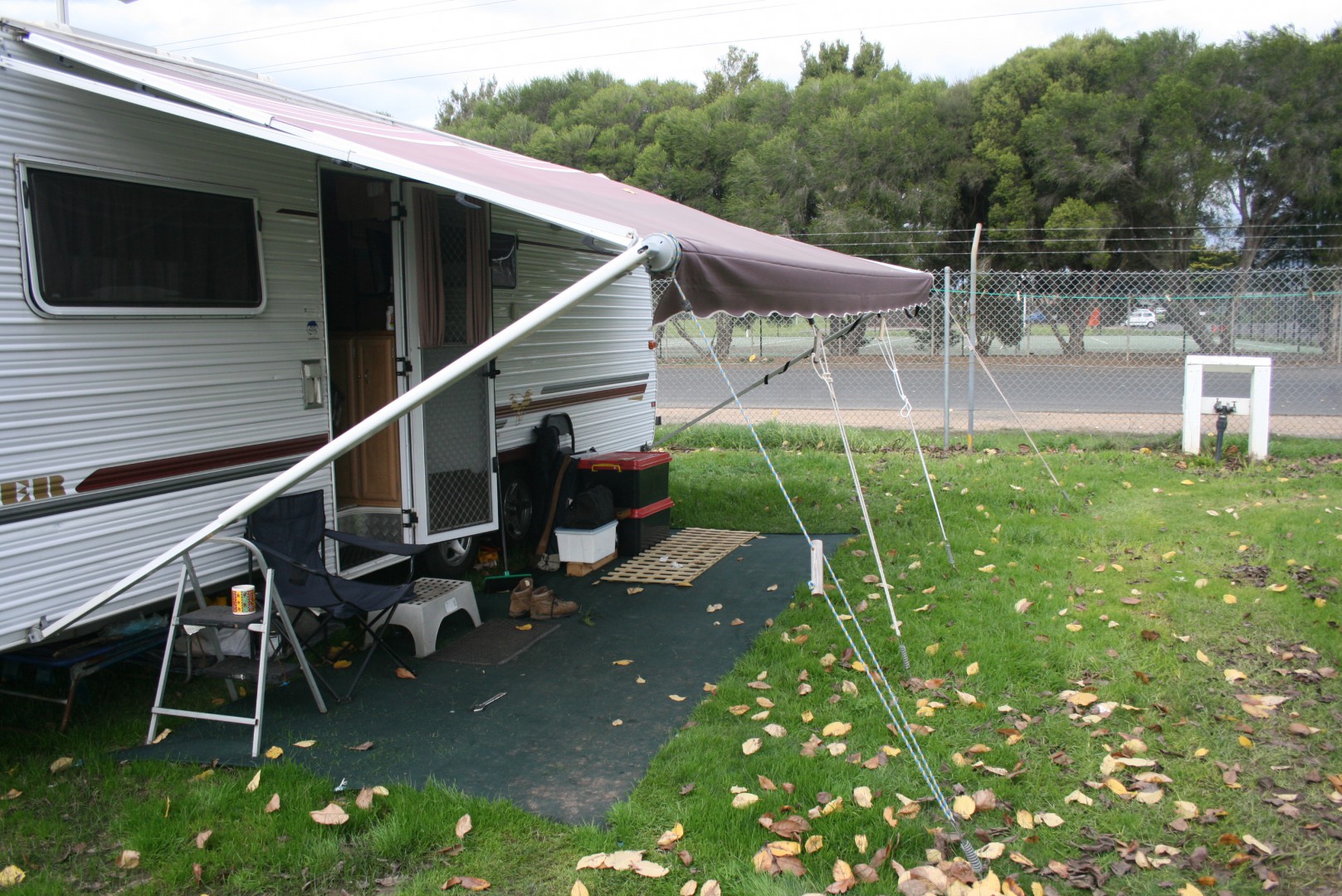

09:12 AM Aug 17, 2016
Here's my setup CC.
It all depends on the forecast on whether I roll up my awning when set up like this.
If the wind is forecast at 35kph or greater and will be coming TOWARD the van - eg allowing the wind to get under the awning and therefore creating a 'sail' - then rolled up it goes.
However, if the wind is coming from from either end or from behind the van I usually only react to forecast winds gusting above 50kph.
Having said, that I have been caught a couple of times and had the awning still out, set up as shown, in 80kph gusts without damage.
I use Aussie-Traveller Anti-flaps on each end and three rafters.

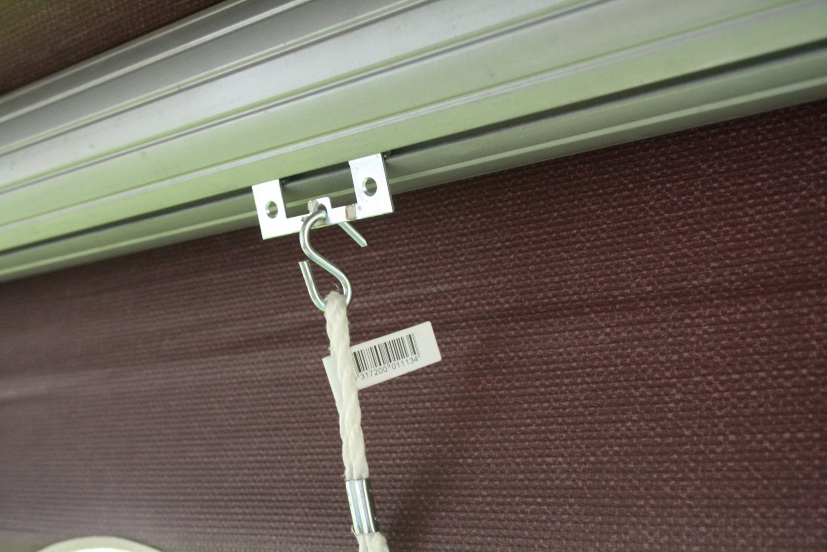

I also 'modified' some hinges (see photo attached) to use as 'internal' rope holders so the middle of the roller doesn't keep raising and lowering in the wind. I have found that the roller, because of it's length, needs to be secured or it just keeps going up and down in the wind which I don't like.

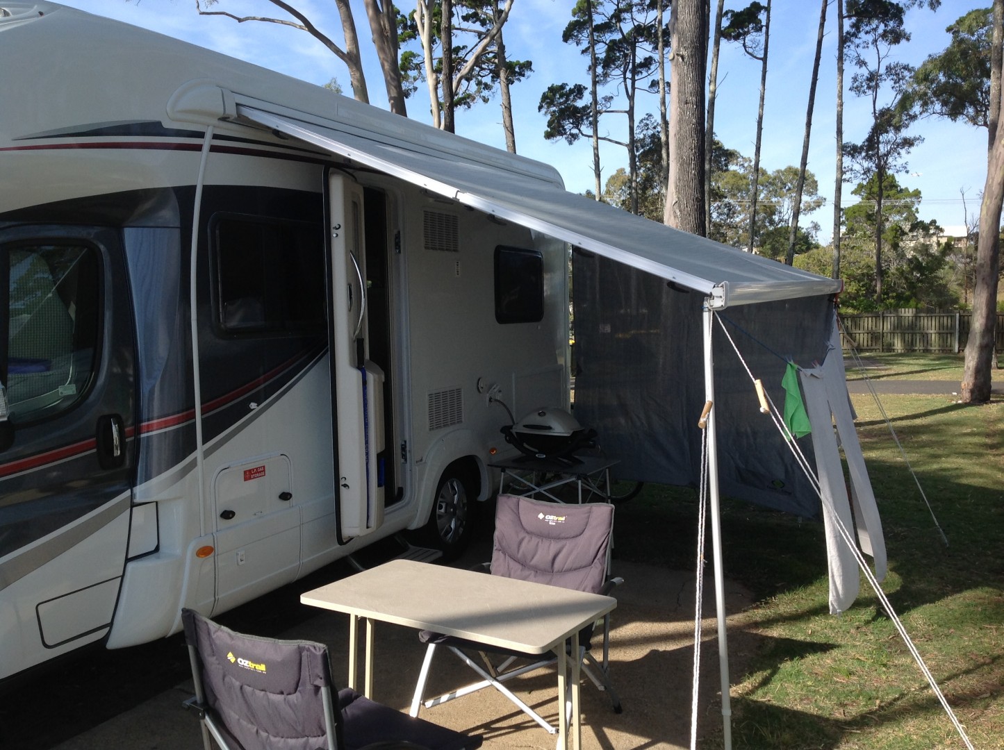

This is my set up Aussie Traveller antiflap said with a central rafter and two spring loaded ropes at each end. I also have an end and side wall to use as required. It is much stronger than the original "sun shade" but if the wind comes up down it comes, it takes only a few minutes. I have had nightmares of that awning doing a back flip in strong winds so for a good nights sleep I always roll it in at the first sign of a windy session. Cheers Gary,

Here's my setup CC.
