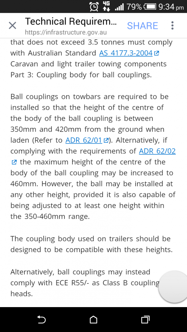

KevKim37 said
06:16 PM Aug 15, 2016
This mentions that the Height can be increased to 460mm. However, the Ball may be installed at Any Other Height, provided it is also Capable of being Adjusted to at least one height within the 350-460mm range.!!
Cheers Kev.
-- Edited by KevKim37 on Monday 15th of August 2016 06:27:40 PM
The standards are refer to the actual towbar height . It is very easy to misunderstand . The actual tow ball and the coupling are at whatever height it needs to be at .
towbar at 350-460 mm
towball can be mounted at any position provided it has one option to be mounted within the 350-460 mm range
Cheers Kev.
hi to all
