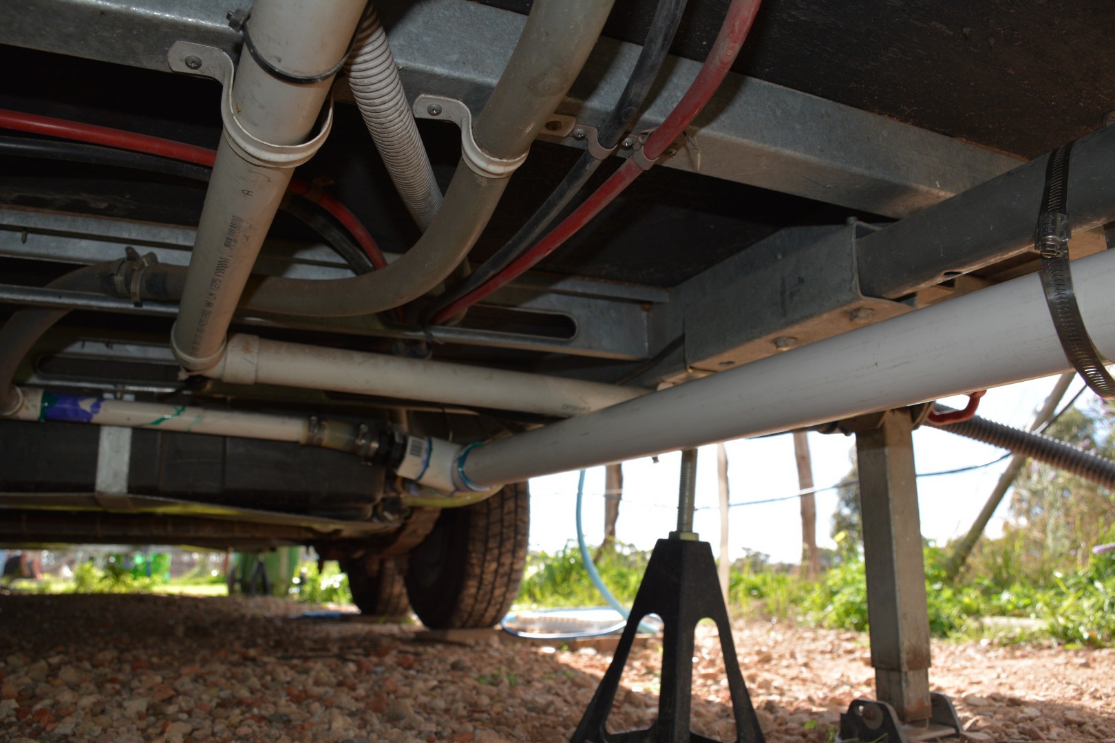

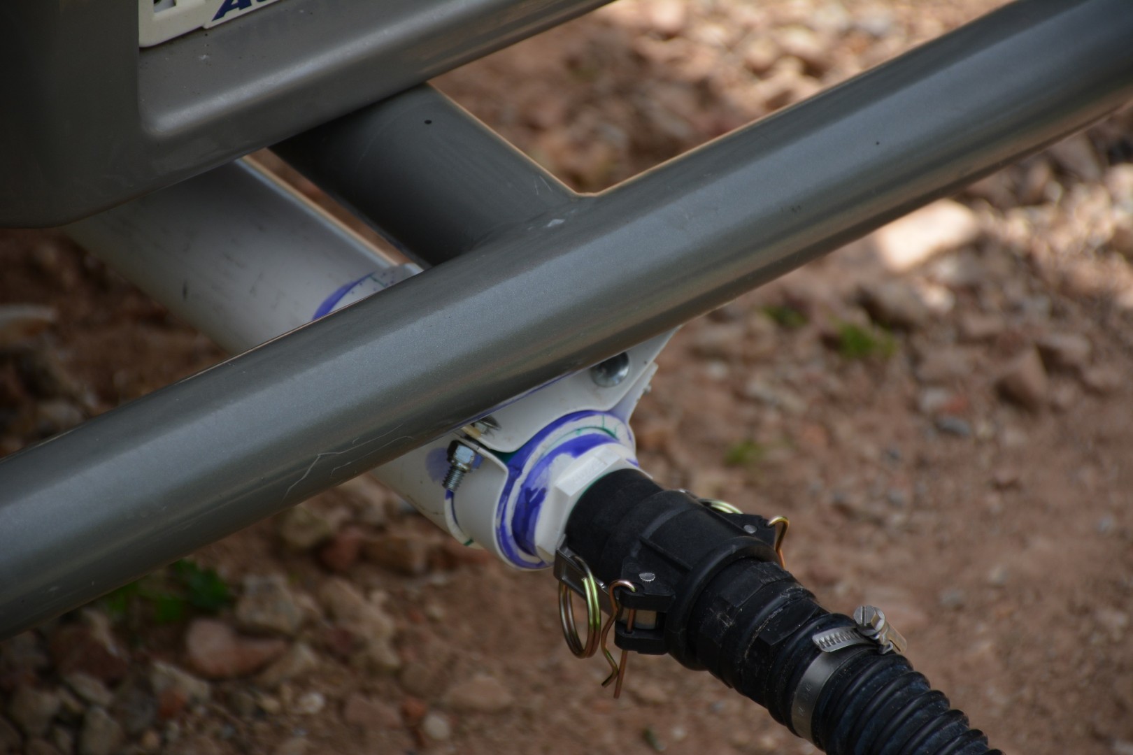

The last 3 years since we started living in our caravan we have had issues with slow drains. In the shower you would have a foot bath and the washing up water would take ages to drain. Also the getting down and pushing those darn pipes in at camp, bit tough for an old guy with lots of arthritis. It seems Jayco, in their wisdom, use 25mm pipes and lots of bends, thus the slow drains.
I did some research and decided a 50mm thick wall pressure pipe (bit more robust than the others) a few connectors, glue, pain, swearing and bingo, problem solved.
Cost about $100 from the local agricultural plumbing supplier. Works well.
Edit: some pictures

Well done BigP. Now it looks like under my van mate.

Well done Phil, gives me a few clues.

Thanks guys, mongrel of a job getting under the van but well worth it. I did it the lazy way and used existing pipes into the main manifold, stops all that BS with the bends.

Are them stands only for safety when you are working under the van, or do you use them all the time ???

Cheers John, the stands are used when we are camping at home base longer term (been here for 5 weeks now) adds a bit more stability to the van. Not a necessity but nice.

I agree Bruce, the extra expense (for the want of a better word) would have been absorbed in the cost of existing drain pipes. Im not sure why they took the pipes via Bourke to get outside, and with all the bends and fancy crap who knows???
Anyway its fixed now and works a treat. We also get super hot water after I removed the tempering valve.. Why a tempering valve on a caravan beats me..
