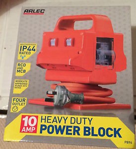

madaboutled said
08:59 AM Aug 6, 2016
For their own safety they should buy a 10 Amp Power Board with built in RCD, that way they can't draw more than 10 amps plus the added safety of the RCD. You can get them at the Big Green Shed. I'd recommend getting the Arlec outdoor type (second image) since they're in a tent.
Ampfibian have a lower priced unit (than their original) for caravanners - See Link.

oldtrack123 said
10:39 PM Aug 6, 2016
They should also understand that there are specific requirements under the Standards for any outlet box used in a tent. So ensure any that are used are "approved "for such use
The strip outlet boards , double adapters, etc ,electrical outlet boxes complying with AS 3105 shall not be used [are definitely not approved.]
The Arlec IP44 rated unit in a previous post is OK but should be kept undercover & off the ground
The other unit is not approved
-- Edited by oldtrack123 on Saturday 6th of August 2016 10:44:24 PM
