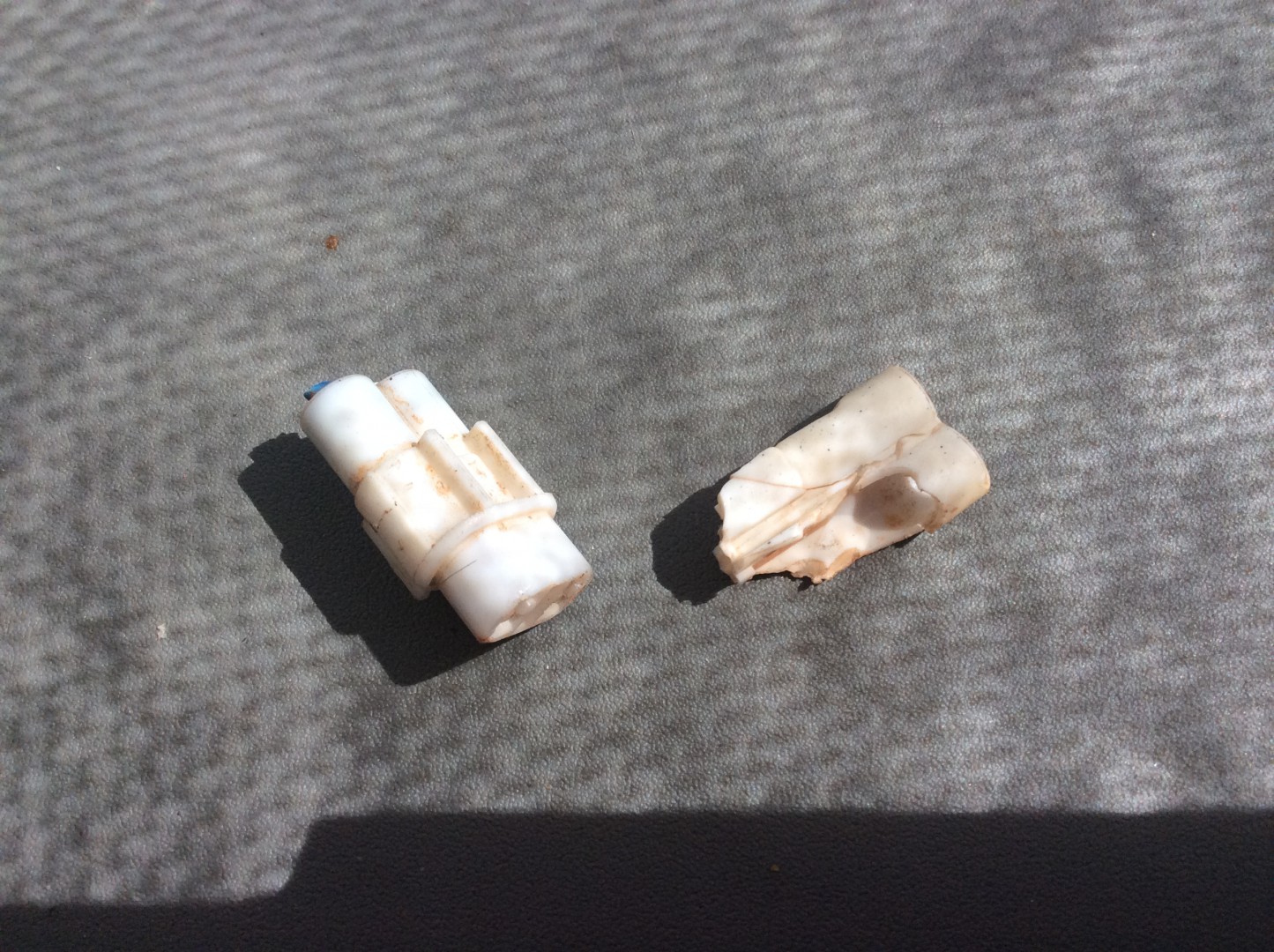

Just filled in an on line report to the ACCC to report a dangerous fault in new Jayco's. The electric brakes on my van and that of my friend (we are travelling together) have power wires leading to each of the four wheels (tandems). There is a plastic joiner on these wires which sit about six inches above the brake hubs. My friend sustained some damage to his awning and arranged for a caravan repair guy to attend to his van at Broome. The mechanic said to check these joiners as "they will be broken. They always are." They apparently break from stone strikes and or vibration. When my friend checked, all four plastic joiners were smashed and separated meaning he had been driving for an unknown distance with no caravan brakes. I then checked mine and two of these joiners were smashed and the wires separated one on each side. Meaning I had been driving for an unknown distance with 50% braking power. Imagine if two wires had been separated on the same side. This would mean the caravan brakes would only work on one side and in an emergency braking situation would seriously de-stabalise the van an probable the tow vehicle. The vans are 2015 Jayco Starcraft and Journey outbacks.
elise the van.

Yes mine are there hanging about to be damaged, and one lead is attached so it is too short, jacking the wheel off the ground nearly pulls the plugs apart. Isn't it great the way as soon as you've brought the product, you're asked to fill out a survey, but down the track they don't want your opinion.
It is a bit of a worry that your mate couldn't feel that his van brakes weren't working at all.

Bill B wrote:
-- Edited by Bill B on Thursday 4th of August 2016 06:50:23 PM
I agree Bill. I manually test the van brakes several times a day, mostly when just moving off after a stop.

I note that these 'dangerous Jayco's' are in the North West of WA around Broome. I ask the question what roads have these vans been towed on????I have a mate at Broome at the moment and has come across the Gibb River Road etc. Tows a brand new Kedron behind a Cruiser. The steel frames holding spare tyres have cracked with the corrugation etc. Lets put things in perspective before making outlandish statements.

aussie_paul wrote:
Bill B wrote:
I think its a bit harsh to totally blame everything on the manufactory without questioning the ability of the drivers to notice a decline in the performance of there braking systems.
Very questionable.
And before someone jumps on here and says this is why we need a lience to tow caravans, a licence in the back pocket would do little to help in this mechanical situation.

My long suffering 1999 Jayco has the normal screw type electrical connectors.
Not a problem over 200,000 km of blacktop.
I'm a Jayco fan & would have reported the issue to them as a first step.

Mutley said
02:57 PM Aug 6, 2016
To the OP - Mate, that looks like normal wear to me & tear if you've been up a long gravel road?
If you have travelled any distance up a dirt road, did you stop periodically & check out your tug & van thoroughly? I'd be spewing at myself if I'd missed something like that when I checked the rig over on a routine stop.
On the Birdsville Track I noticed the wires on my off road CT electric brakes were broken like that by stones on the track when I stopped & checked the trailer over, I just fixed them on the side of the road. Was it the manufacturers fault? No! It was a stony road that broke them. I can't even read the writing on the compliance plate on that trailer any-more, because of number of stones hitting it (I use a stone guard too!). Its a big ask for the wiring not to cop it sometimes.
We do a lot of gravel roads/dirt roads & we've seen D shackles lost, 7 pin plugs come out, Andserson plugs shake loose, plumbing hoses come adrift....................... All just normal wear & tear for that type of travel. Even had some of the bolts that hold the locking hubs onto the front wheels shake out in Lorella Springs. Saw a new looking CT minus a leaf spring on the Mereenie Loop Rd once. Saw the spring on the road a few K's later!
Our vehicles are always very well maintained & heaps of planning and preparation goes into every trip, but as Forrest Gump said, it still happens!

Edit: Why doesn't Jayco dress its external cabling in the same way that car manufacturers do? For example, I can't recall any auto maker having to recall vehicles due to damaged cabling to ABS wheel sensors or the like.
This is a serious safety design fault putting all road users at risk.
A major manufacturer should know better and don't deserve the courtesy of being advised rather than an enforcement body like the ACCC !!
They should be prosecuted

Perhaps Jayco should take their products on "the country's unsealed roads" and see whether their claims measure up. Hopefully they will then understand why mechanics say that "[the cable joiners] will be broken. They always are."
