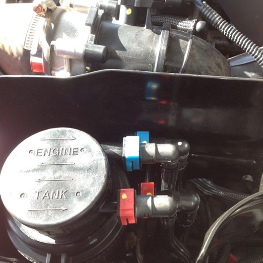

G'day everyone. CASE CLOSED!! Got a hint from another forum that the hoses on the fuel filter could have been mixed up. They are color coded in two colors, and both of the same color have to be on the same side. How hard can that be! Towed the van over to Traralgon. Stopped 5 times. Mentioned the hoses clue to the Service Manager and left it to him. Sure enough they had been mixed up by the mechanic on the last service. I must admit it was not a Mazda dealer. I have a mate who is Service Manager at a Toyota dealership and he has been looking after all our cars for years.
I suspect one of his men will be getting a size 9 up the clacker today!! Sincerely, thank everyone for their comments. Cheers, Brownie

Brownie2 said
10:47 AM Aug 2, 2016
Photo of the filter with hoses in the Correct position.
Good to see it was such an easy fix and such an obvious one, simple mistakes can happen in busy workshops.anyway it's worked out well in the end happy days thanks for the photo...

BTW still cost us $68 for you to provide the solution!! Happy to pay it by the way.
