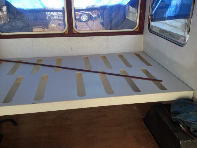

I know it's too late for me to change anything but the issue of ventilation under the mattress was of concern to me when rebuilding my van. The slots you see in the photo were my uneducated quess at what might be needed.
Could some of you with actual practical experience please comment if I have covered the problem or should I plan to look into the air circulation mat that Bill B. linked to?

I am a chippy and made a few caravan beds in my time. That looks pretty much all you need Grandad5.

I have made a couple of beds including the one I sleep on at home for 25years now, as well as some in campers. I hate a soft bed. Just a good mattress on a hard base.
So all I do, as already suggested, is use a 50-70mm hole saw and put holes in the ply. That method of slots shown is too much work for me but looks effective. However you do not really need that much "hole". Say 4-6 across and say 6-8 rows would be enough. Never worried about the underspace being specifically ventilated.

A big thank you to Jaahn and Millsy. You've successfully put my mind to rest.
Millsy, I'm a self taught chippy. Cabinet maker by trade.
Jaahn. Slots were easy using a router. Once you've got and used one you'll wonder how you ever got along without one.
This part of the project was a case of how much is too much or how little is too little. I decided to err on the side of too much and then restore lost strength by reinforcing underneath. I am happy with the strength. Now I'm also happy with the ventilation aspect.
