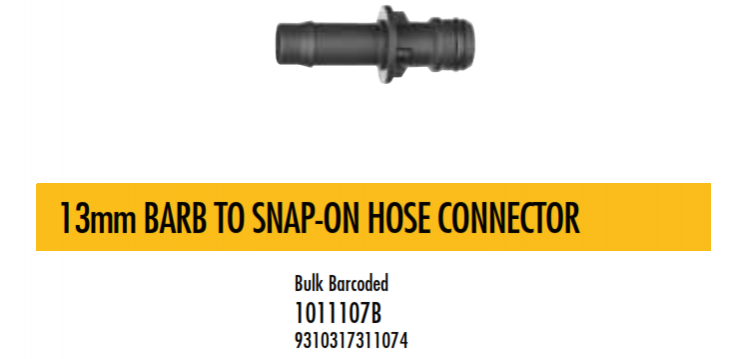

Use a hose that does not have any fittings on the end. Stick the hose down the filler tubes 100 to 200 mm.
I use this fitting on a piece of hose around 400 mm long. I click the fitting onto my water hose and stick the other end down the filler pipe. Works for me.
