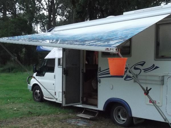

We have an everpure water filter system that I built into the van under the sink that filters any water that is used for drinking and cooking.
I also catch water from the awning wasting the first few ltrs to get rid of contaniments then put all that is caught after in the tanks until full. We have used this system for a few years now without problems.

I have a luggage rack above storage compartments on the back of tug. Simple to collect up to 100 litres of rainwater when rains expected place a plastic or tarp liner over the rack allow to fill with rainwater then I can pump or siphon collected clean water as the tarp in use IS clean with no collected sediment. Works for me. Cheers Allen
