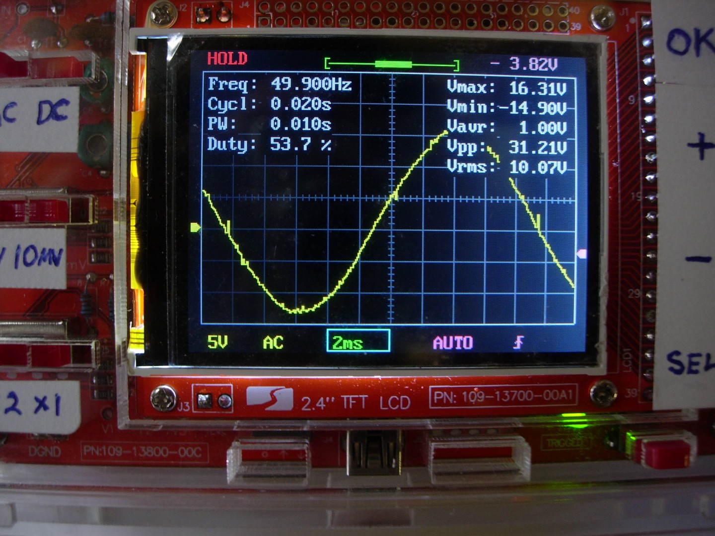

Thaught id just show you this little compact LCD CRO Phil c. They are available from Banggood on E Bay for $36.76 freight free, I have built 2 of them & use them quite a lot they are only 200Khz band width but are quite usefull for vehicle electronics. http://www.banggood.com/DSO138-DIY-Digital-Oscilloscope-Kit-SMD-Soldered-13803K-Version-With-Transparent-Acrylic-Housing-p-1051616.html The pictures are 240V ac through a small transformer fed to the CRO, showing the wave form, of Mains then a Jaycar 12Vdc to 240V ac 150W Square wave inverter. I have not had any trouble using this unit to run plug packs for phones or running a small 240V AC fan of it. I do have a larger CRO but I find this fits in the tool box & you can freeze frame it. There is a small amount of noise on the wave form which is in the internal pre amp, which I just ignore.
-- Edited by DeBe on Tuesday 12th of July 2016 04:16:15 PM
Hi DeBe, love the idea of the CRO. There will allways be discussion on mod square wave, square wave and pure sine wave inverters. For me I went the pure sine wave, way too many high $ gizmos to risk damage.
I looked on fee bay and may get a kit, although my hi rel soldering skills may be a bit low rel. May resort to load the board and get a mate to wave solder it.
DeBe said
06:03 PM Jul 12, 2016
On that particular kit all the surface mount components are already fitted, the rest are through hole components & not too difficult.
