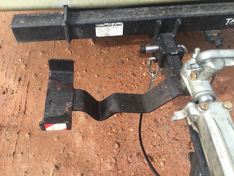

Hi NG, not sure if you got one of these with your Hitch 'n Go, the frame can be swivelled around and rests in the 'tray' when unhitched from the car. Unfortunately my Hino is fairly narrow and the ends of the frame extend past the side of the bus. I just wrap a bungee cord around it if I need to manoeuvre around a campsite or whatever.
