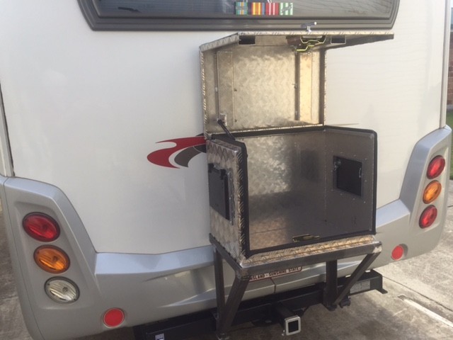

I recently purchased an aluminium generator box with side breathing vents, purposely designed to house Honda 2kva generators. I intended to fit this box to the rear of my motorhome. Following construction of a supporting frame for the aluminium box, I secured the generator inside and then mounted everything to the rear of the motorhome. Being very pleased with myself, I decided to trial everything. It all worked beautifully until i tried to plug in the electrical cord. This is when I discovered a problem with the unit. For anybody considering doing the same, please be aware that when you try to connect your 15amp electrical lead into the Gennie through the breathing vent, you will be unable to do so, due to the vents being too high. The vent just doesnt line up with the female connection. It misses by approx 30-40mm.
However, there is a solution to rectify this matter and that is to buy a 15amp male plug that has a flat front, with the cord emerging from the bottom instead of the usual plug that is connected to every lead. As my brother is an electrician I had him make me a short extension lead that I have plugged into the generator on a permanent basis. Now all I have to do, is start the generator, open the vents and connect my other long lead to the short lead, and I am away.

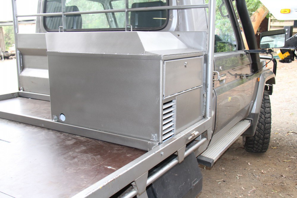

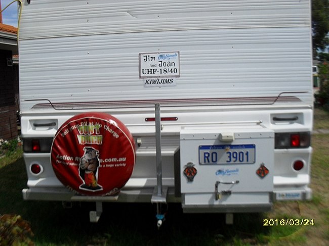

Here's my version of a generator box which I built out of scrap Aluminium, then built an angle frame and welded it to the rear bumper, It's water proof and vented at the rear, also has an S/Steel exhaust tube on it, ( l/hand side of box ) so the Generator can be run in all weathers...............
I have access to the twin 15amp Power outlets through the small door on the R/H side, There is a grove at the base of this door which allows it to close over the power cables, should it start to rain.

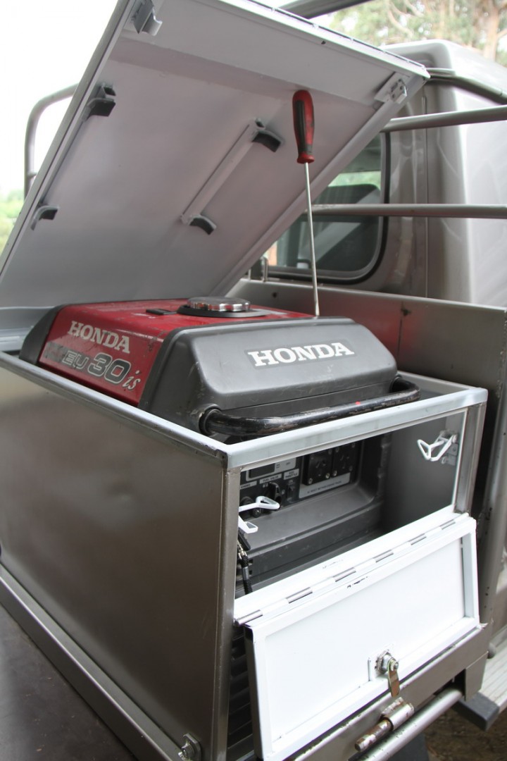

For those towing a van or fifth wheeler with a ute or truck the set up that I built works really well. Generator is a Honda 3Kva ,electric start (which I have converted to "remote start" ) and is permanently plugged into the van . Only reason to go near the genset is to refuel (infrequent) and the 3 Kva gen set is super quiet as it rarely runs at more than a fast idle. Can be started from in the tow vehicle cab or from within the van - via a simple key fob remote (similar to a garage door remote controller ) Cabinet is weather proof , ventilated and secure. "Mains -Off -Genset " switch in the van controls electricity supply source.
Thought this setup may be of interest to someone. I can supply details of where to obtain the Remote Start System for anyone interested . The Genset I paid $2K for from EBay. I built the cabinet.

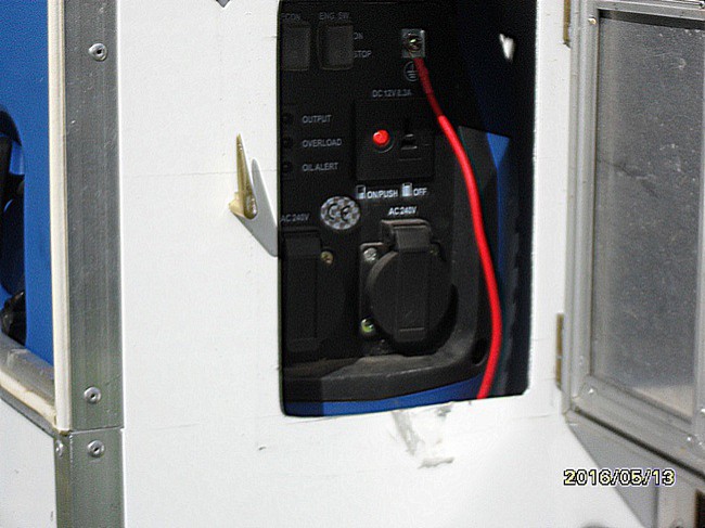

With reference to the generator box problem, I am just attaching a couple of pics. Unfortunately it doesnt really show the actual problem as the Gennie isn't in the box at the moment. However, you can see from the photo that the rich hand vent is too high to line up with the plug connection - theres not enough gap on the side to put a normal plug lead in.
