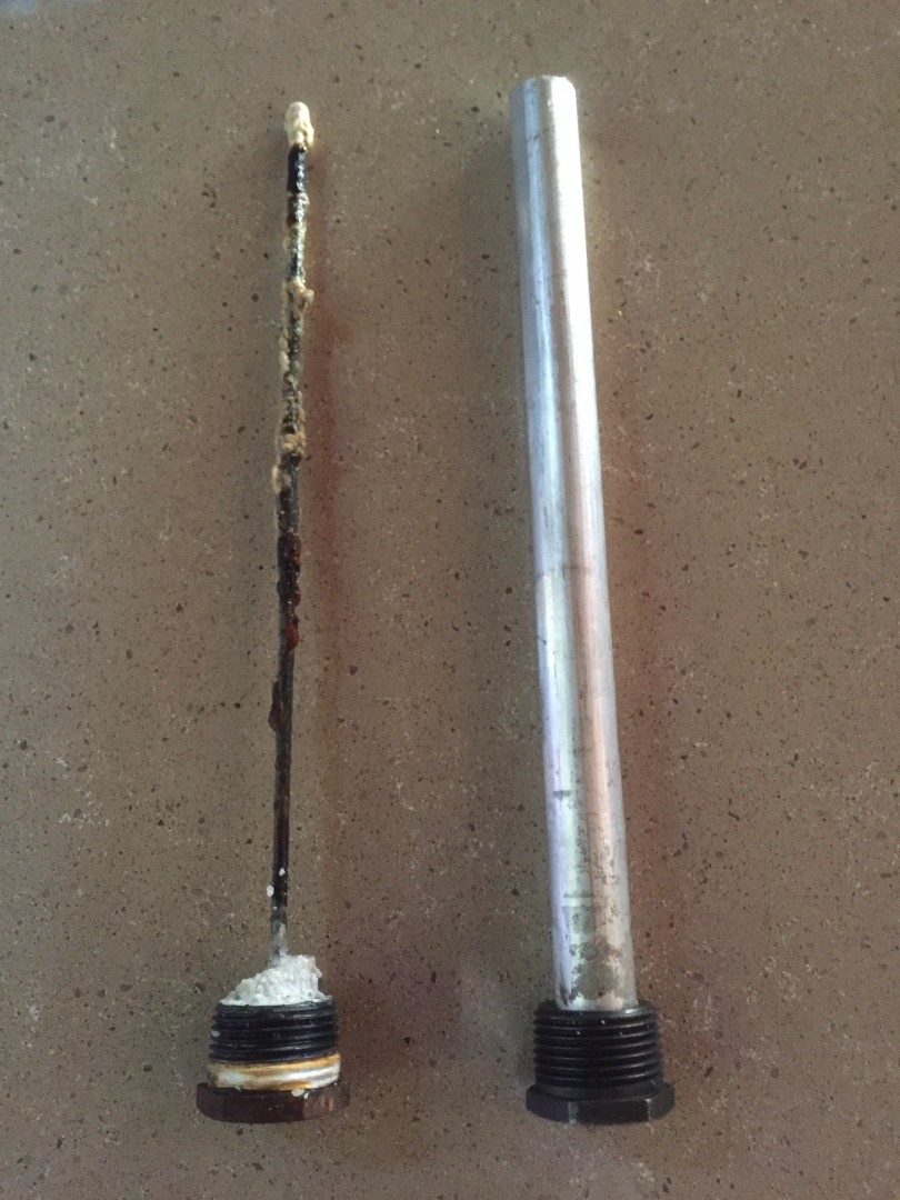

Here's a photo of my old and new anode. Had not checked it for a couple of years.
You certainly got plenty of ware out of that one. LOL.
I replace ours every 12 months. They've never been eroded too badly but for around $30 why stuff around ??

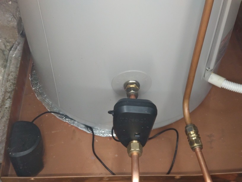

I recently installed a new stainless steel 80L Rheem Stella hot water tank in a property that I let. It has a 12 year warranty.
A couple of points I took note of. The tank is so much lighter than the previous standard Rheem tank. The plumber said I had just replaced it in time as a lot of rust came out of it, which he installed 10 year previously.
My neighbour had an 80L Rheem standard tank fail at 4 years & flooded his Unit & Unit below. Now has stainless steel tank, flood tray & mains cut off switch.
Another neighbour had a 120L Rheem standard tank fail as well, years earlier.
Also has far better thermal insulation properties.
I have actually added additional insulation as I did on previous tank. Reducing standby heat loss from 1.67kWh/24 hours to 0.95kWh/24 hours.
I haven't been able to measure standby heat loss of the new stainless steel tank as new tenants had moved in quickly.
But I do measure hot water tank efficiency when the opportunity arises. Also has copper flood tray & main cut off switch (4 x AA batteries to be replaced every 12 months). Not actually required when not above another property by I did it anyway.
The "U" shape out of the tank is a thermal trap to prevent heat loss, which most plumbers don't bother doing.
My recommendation is spend a few dollars more & go stainless steel tank & also flood prevention measures, even it if not actually required by legislation. Cheaper in the long run.
