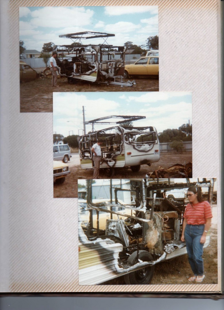

I can vouch from personal experience that leaking gas and pilot lights is a lethal combination... a brand new van, had done 200kms, reached Bordertown...the photos tell the rest....
van......Hoo Roo
I was on my ""honeymoon"" with a brand new spouse in 1984....our marriage has endured longer than that new Poptop...however took me quite a while to convince her to get a
It looks like the Young Couple weren't told the golden rule of caravanning......
NEVER TRAVEL WITH THE FRIDGE GOING ON GAS !!
