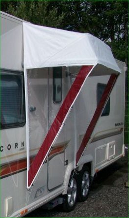

The awning on our van is 6 meters long, I would be nervous about leaving it up in any sort of weather. Recently we were camping and the weather was rather rude. Getting in and out of the van in the wet conditions proved trying.
At work we have a stock of banners, made from the same material as awnings, and with ropes sown in, I was wondering about the idea of riveting in the alloy tube that you can run the awnings in above the door, and setting up a mini awning. This could be left up in any weather, and if it get torn what the heck. And at the same time giving us some protection from the weather when entering or leaving the van.
Any thoughts on this?

It's a problem we all have Ian. Your idea sounds good but you would have to go either side of door quite a bit to stop weather getting in from the sides. Due to the top edge of the door you would still be limited as to the angle you could put the cover. Better than nothing though.
When I set up at for any length if time I have ropes and long heavy pegs all around. It has been called "rope city" many times. It has also been through some very rough weather.
Hope your idea works if you go through with it.

We got a 'door cover' made while we were at Kenilworth. Needs 4 - 5 poles (comes out level with awning edge, plus it's high as we are a bus, so needs support), similar number of ropes/pegs, and slots into a sail-rail thingy (yeah, technical terms, I know) like the annex walls, and velcroes to the awning via a special strap thing the bloke made for it. A bugger to put up/take down in wet or windy conditions, but we can get in and out without getting doused.

When our awning is up, I shake my head in disgust. It has the sail area of a good sized yacht, but the hardware is still the same size as awnings of a much shorter length, meaning that not only if the wind gets under it there will be tremendous forces, but the hardware is correspondingly weaker. If I had my way, it would be coming off and the whole thing cut to half size. After all there will be only two of us.
But yes Dougwe you have seen the problem, unless it has sides, the weather will still come through.

iana and friends, Here is an idea from another forum and is right up your ally, complete with pics. It could be adapted and made to an length you need.
I always worry about deploying the awning. Several times I've had to get out of bed in the wee hours to furl the awning due excessive winds. My view is the awning minimum deployment setting is too big. This minimum setting is when the upper arms are deployed at their shortest position.
To overcome this I made my own discrete upper arms. They are all aluminum and very light. They enable the awning to be deployed and firmly tightened at about 2 feet less than the standard minimum.
To use them the awning is unfurled to a position I marked on the awning. The existing awning arms are left lowered and unused and the new arms then placed in position between the awning mounting bracket on the van and the awning roller or drum. The awning ratchet is then released allowing the awning to recoil and firm up on the new arms - but only to the nearest ratchet locking position. Then the arms are slightly extended with the arm wheel adjuster to remove any slack. Now the awning is tight against the drum locked ratchet.
To further minimize awning flapping (still likely with a taut awning, as with any flat sheet) I fit the 3rd curved arm or rafter in the centre of the awning. This introduces a curve in the awning fabric and kills the Rolf Harris 'wocker board' tendency.

In wet and windy weather we partly pull the awning out approximately 2 1/2 feet works well in shielding the doorway. Not so much sail area for the wind to catch and limits the area for water to pool on top. It works well, but if to severe conditions of course we put it in.
