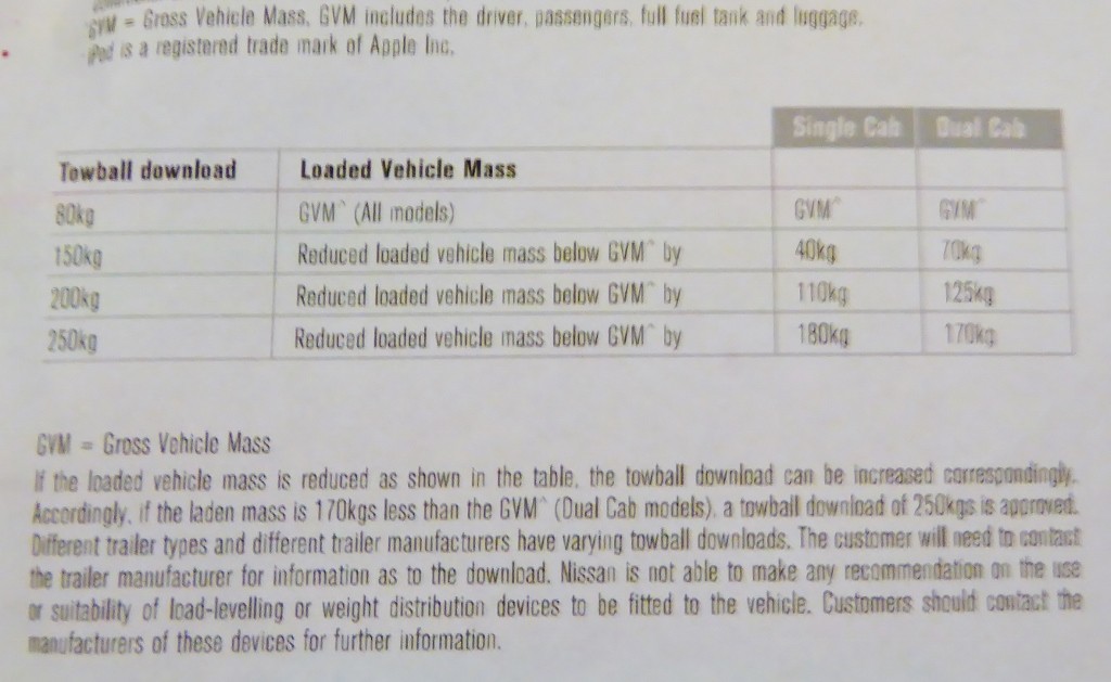

Yep, you do each wheel sequntially and it reads out
1. weight of that wheel
2. weight of each side
3 weight of each axle
4 total weight of vehicle/van.
5. towball weight.
This is what I got, the yellow one suited my vehicle(s).
I checked the weight from this scale on a weighbridge & it read high by 2%. Good safety margin I think.
Cheers Neil.

A secondary consideration with this dilemma is that your van would weigh a whole one tonne more than the tug - a recipe for disaster in my humble opinion! 'Tail wagging the dog' comes to mind.
It's a bit messy trying to get your head around all this, but it's necessary if you want to stay legal and safe.
There's a good article on this in RVDaily...
http://rvdaily.com.au/issue001/?utm_source=ActiveCampaign&utm_medium=email&utm_content=The+Big+3%2C500kg+Braked+Towing+Rip-Off&utm_campaign=RV+Daily+-+Send+004#223
No mate, never owned a Navara, but my lad has one. He only tows a camper trailer though and has kept his car pretty light.
Quite scary realy.
2006 Lexus LX470 V8 auto. Same as 100 series Toyota.
-- Edited by GerryP on Sunday 3rd of July 2016 09:52:23 AM
I was thinking the same thing funny how a safety issue scares people of haha
dibs
I would hope that a safety issue worries people. Everyone should have concerns if an issue affects their safety and the safety of others.
