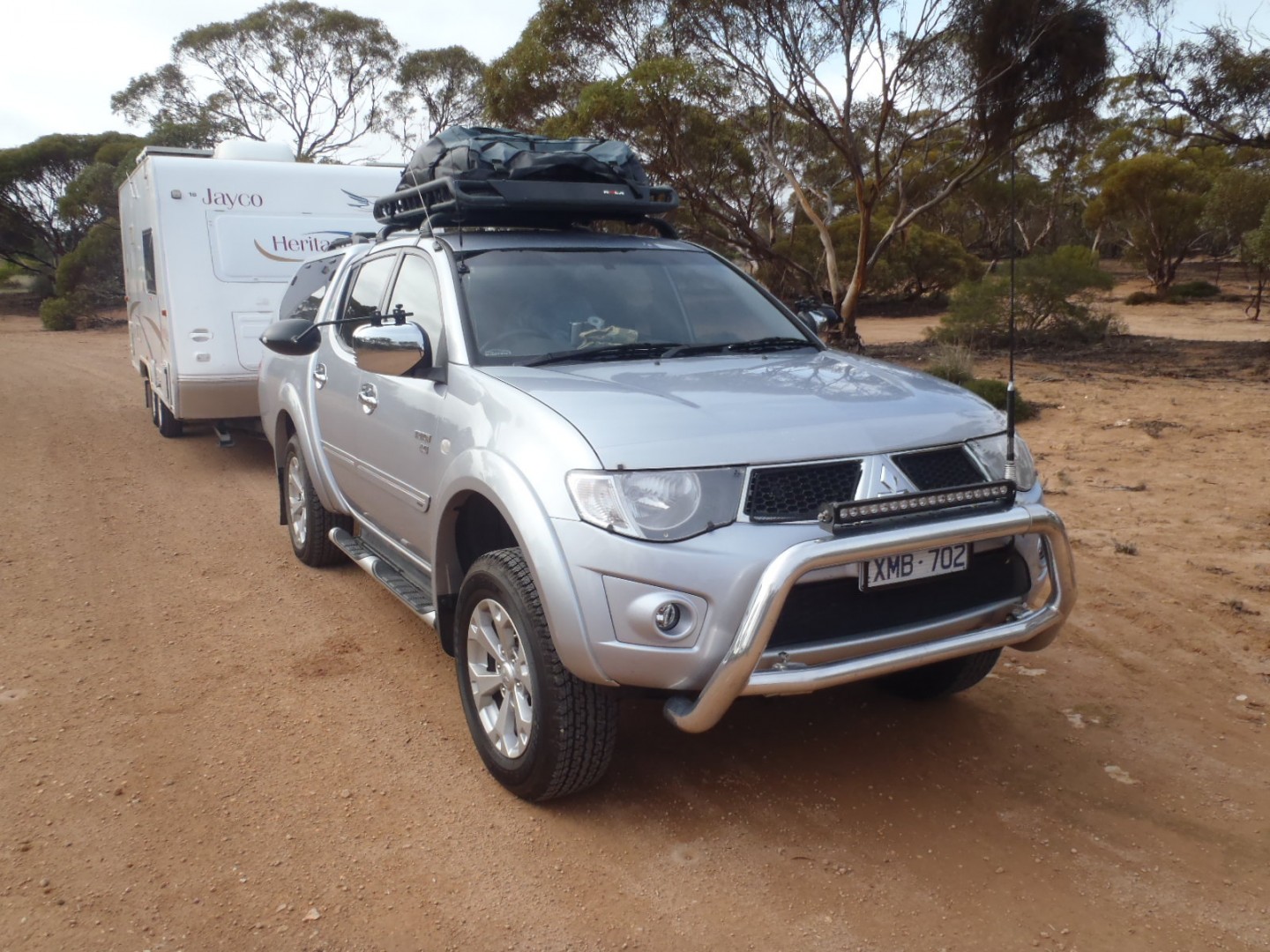

G'day U/Wombat, unlike Phantom I won't attempt to answer your question by asking another question...
I have a Light Bar by 'Great Whites'....fantastic for driving at night where you're likely to find Kangaroos or wandering stock...
They are the nearest thing to daylight I have seen and I have had all the usual driving/spot round lights during the years...
Great Whites are not cheap if you Google however they are far superior to Chinese gay pretenders...both in light and indestructability from stones etc....
They use very little power draw, run cool and I have mine set up to dip with my main beam...I think its mandatory...
They are superior to long range spotties because when I'm driving back tracks in the donga I don't need to know if there is a Roo 3 Kms ahead I need to know what's either side and front in the immediate vicinity...
I often see on Forums someone will raise that you have to have 2 lights and that only one is illegal...I've driven with mine through 5 States and also seen hundreds on passing vehicles...
If I'm ever picked up by a pedantic Plod I will tape the centre with plastic tape ...voila' two lights....it won't melt the tape as they run cold.....

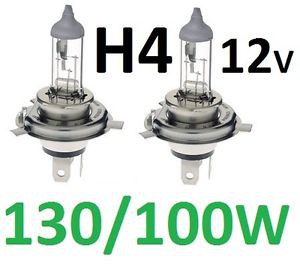

Well, I've solved my light problem on the cheap,
I went onto Evil Bay and put in an offer for a Pair of upgraded head light globes for the Nissan,
The sales price was $26.00 I was successful on saving a couple of Bucks and got them with free delivery,
I've since fitted them and "WOW" what a difference. I can now actually see where I'm going, but as someone has said, it's back to half light when I dip them.
Photo of my set up....Hoo Roo
K.J.
