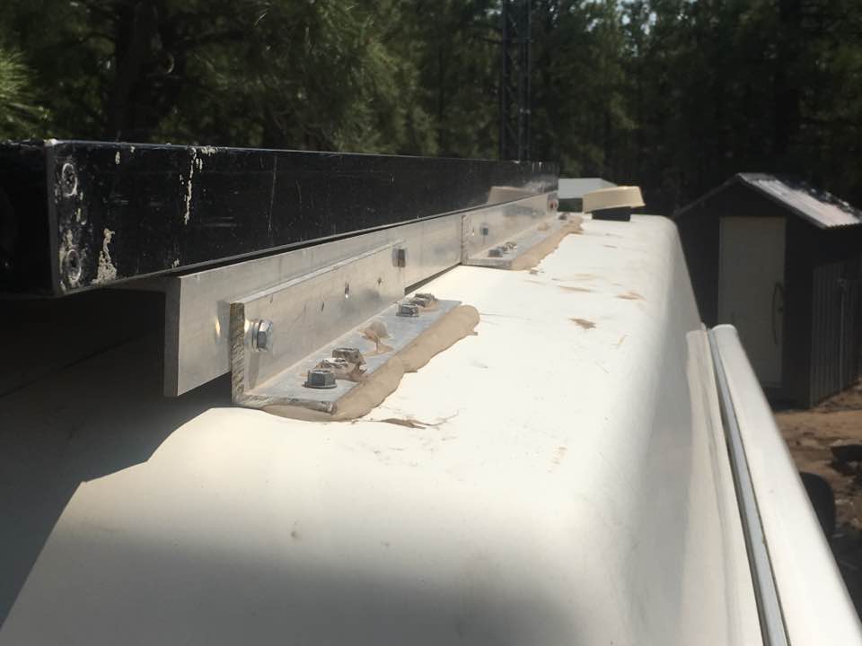

We mounted 5' x 1" aluminum stripping ((1/4" thick) on the solar panel flanges. Cut 5' sections of the 1.5" (4 cm actually) extruded aluminum and bolted this through flange and stripping. Then cut more of the extruded aluminum (due to curvature of roof). Moved things about. Bolted the lower sections to the 5' long sections and then bolted to roof with a lot of silicone glue. This may be over-engineered but the panel will not come loose

Our son Cary finished fabricating the solar/LFP array on our 2002 Roadtrek 190. There are two panels: 315 W and 100 W. Since they have different voltages, he had to utilize two chargers. The cabling is run though the a/c housing and down the corner of the left rear door. The battery suite is two x 180 amp (12 V nominal) Manzanita Micro (each is 4 x CALB LFP cells). The batteries are under the bed. Each battery has an internal blower to keep the batteries cool. Son Cary then installed a high efficiency blower that exhausts air to the outside. This will cool the batteries, inverter (2.5 kW PSWI), and other electronics. It will remove four volumes of air per minute from the "electronics compartment". We knew that the installation of the batteries, inverter etc pretty much used up the rear storage so we purchased a StowAway box that we installed on the rear of the vehicle.

Back in US. Wife had shoulder operation and we are at older son Cary's place (the solar engineer/fabricator/contractor) at 7600' (2400 m) or so in mountains of northern NM. Daytime temperatures are 22 C with considerable rain.
Younger son Charlie and family (and daughter Elisa) visited us for a week on beach above Tulum. Would have been hard pressed to get the maintenance done without him. The 315 W panel tore off when a bolt tore through the mounting flange on the panel - which ripped loose the other mounts. Winds at Isthmus of Tehuantapec are world famous. The isthmus is bordered by 3 km mountains so that pressure gradients between Gulf of Mexico and Pacific Ocean can create horrific winds.
