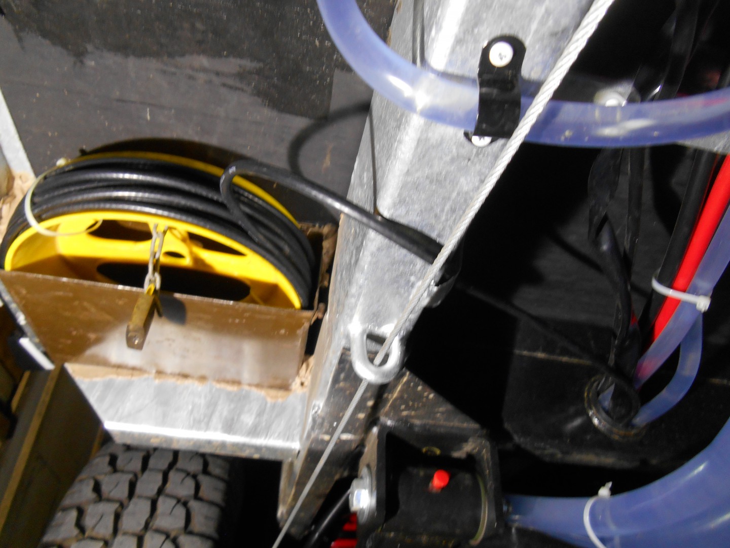

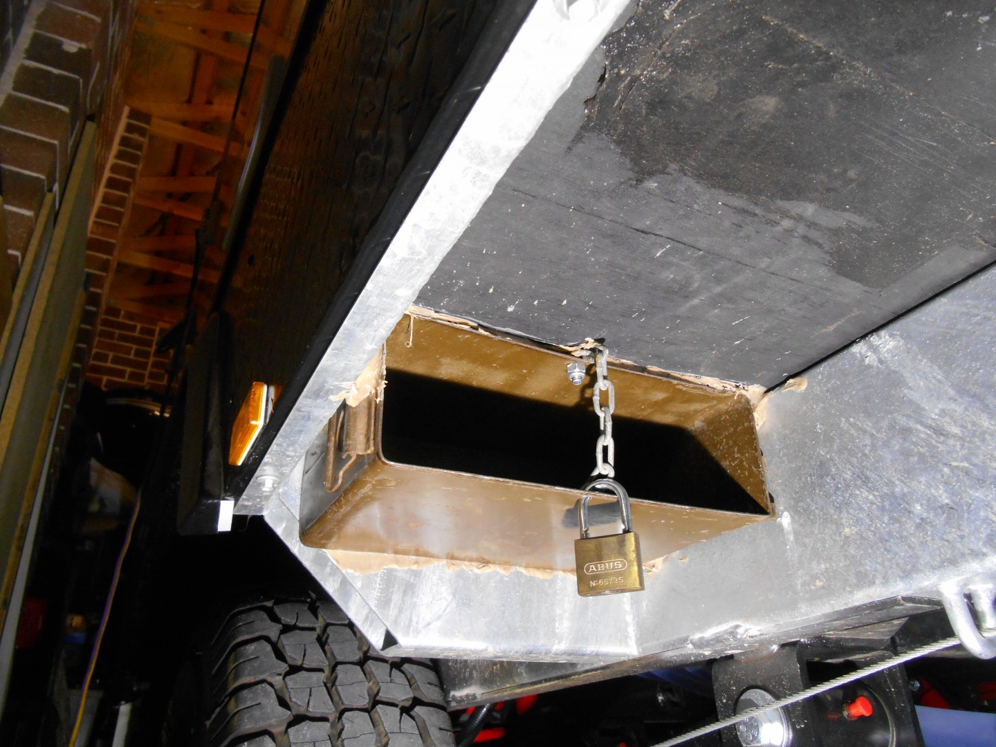

I just finished what the brain told me to do. I had an old ammo box hiding away for a rainy day. That day just happened to coincide with today. She was a bit worst for ware as I had run over it some 40 years back as a young sporting shooter. I used it to keep the ammo in it. however it got slightly run over in my trusty 63 beatle.the lid was slightly worst for wear.
The box is 250mm long x 80mm wide x 165mm deep without the detachable lid. My plastic fishing hand caster 230mm.
So away's I go back under the van to do a Study. Um yes well those water hoses come right through the bottom cuboard from under the van,
I go's back inside the van and follow the same hoses. I can push a pencil down the same grommet. out comes my trusty plastic tongue & grove strip and up the wall one go's.
All clear. Can I get the other end of my rounded end of the sat cable back down the service hole. Yes I can, we are in Business. 10 minutes of slowly guiding the cable from the inside to the outside. With the other end screwed into the back of the STB. red ,white and yellow plugged back in. Power plugged in. Close the cupboard son.
Back under the van we wind onto the fishing caster, all of the cable ( lead first). Secure with 2 cable ties and she slips into the old ammo box. I drilled a 13mm hole thought the hand caster, 2 x 6mm hole through the ammo box fitted 100mm of gal chain via a cup head bolt and 6mm nylon lock nut. to the other side a 35mm pad lock.
Tonight I used my fold up van step and van jack to hold the ammo box in place while the Extreme liquid nails ( big green shed $5.55) sets over night. Job done.
I will post some Photo's tomorrow. One and a Half hours of my time.

Hi Everyone,
Thanks for your help.
The Brain has told me that I want to keep the Sat cable attached once only. So the body will climb aboard the garage creaper and slide back under to see where I can attach a hand caster fishing reel that I us now to hold the total cable in place with cable ties, with the cable passing straight up into the cabinet. A small holding box 400mm x 400mm x 100mm would be nice the brain has replied. An extra large old ammo box would be nice. Thankyou brain, I will look on flea Bay.
Hi Phil,
Its OK to just call me Jim.
All clear.
Hey Jim
Get yourself one of these. They have no influence on your cable other than just as a straight pass-thru to get from exterior to interior.
And the final Result.
