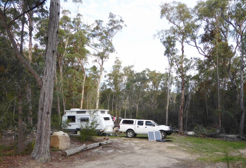

As long as you have decent ground clearance & drive to the road conditions any caravan will be fine. We spend most of the time camped in the bush by ourselves, predominantly accessed via unmade roads. Not a problem.
it seems that these have an independent suspension and larger tyres (15").
Independent suspension does absolutely nothing for a caravan, in fact most are non load sharing and that is a serious disadvantage.
A more compliant suspension with higher wheel travel will be kinder to the van and contents, but that can be achieved with any type of suspension and leaves are typically tougher, simpler and lighter (as well as cheaper). Leaves also have better inherent friction which means shockers will last longer.
Independent suspension on a caravan is mostly a fashion statement.
Larger diameter tyres with higher profiles are preferred, so 16".
