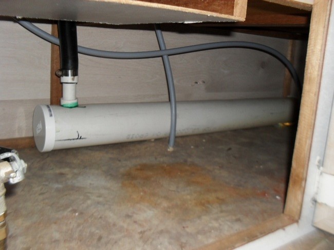

While rebuilding our Coromal a short while ago I added my own version of a grey water tank,
This "tank" consisted of length of 90mm PVC water pipe, capped on both ends with an inlet from the Sink and an outlet at the other end down through the floor with a shut-off tap and hose connection attached under the Van.
It works very well and holds two sink fills of water before becoming full, ideal for a short stop in an overnight parking area.
K.J.
Rather like this idea K.J. If you haven't patented it yet I might copy it.
Vince

kiwijims said
05:19 AM Jun 13, 2016
Vince wrote:
K.J.
Vince
No, Haven't worried about a Patent on the idea Vince, Go for it, just make sure you use plenty on glue on all joints,
Best of luck. Cheers K.J.
Bryan said
09:16 AM Jun 13, 2016
kiwijims wrote:
Vince wrote:
K.J.
Vince
Great idea, I'll copy it but under the van in between the chassis. That is neater than lugging two 20litre jerry cans.
-- Edited by Bryan on Monday 13th of June 2016 09:16:41 AM
