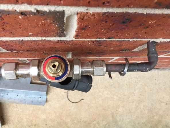

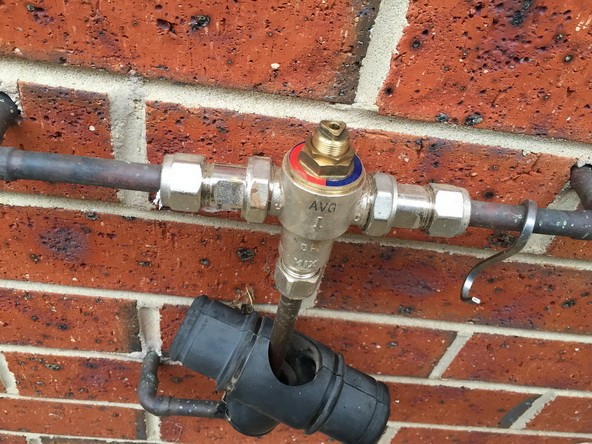

I'm no plumber but my guess is it's a tempering valve for the hot water
valiant81 said
09:15 PM Jun 7, 2016
Hi Aussie Paul;
I have the same thing at my house and it is a constant hot water control. This Mixes the hot water from your water heater and also the cold water so as the mixed water is not too hot to scold ones self with the water being too hot. The water is hot enough for a shower /bath or the washing up of your dishes ??
It's now a safety thing that is fitted to new homes fitted with instant gas hot water, I don't know what they do for the modern storage or electric water heaters for basic temp control. Older electric units have a temp thermostat and the same would have been for gas storage, newer systems a plumber would have a better idear.
aussie_paul said
09:25 PM Jun 7, 2016
Thanks Guys, that is what I thought it was BUT the water temp is the same in the kitchen as in the ensuit. Time to see what the plumber, who installed it when the house was built 4 years ago, has to say. In my opinion the kitchen and laundry water are not really hot enough, 48 degrees.
hako said
10:29 PM Jun 7, 2016
It is possible to prise the plastic top off the valve and turn the 3 sided knob with a pair of long nosed pliers or similar - experiment to find your ideal temperature.....that's exactly what the plumber will do plus he'll charge you at least a brick for the service.....of course I'm not suggesting you do this but it's just possible I have.
Good Luck.

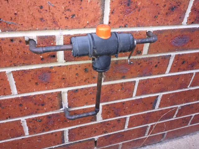

macka17 said
10:30 PM Jun 7, 2016
Don't know where you are. but by law. (In Queensland) they are set at 48/49 MAX.
in case of kids using the hot tap.
That tempering valve and others can reset to what you want.
Mine I set at 53deg.
How.
Nearest hot tap to tank/tampering valve.
Turn on. Hold a thermometer (I used a freezer one) under water flow and turn till it reaches, and holds the temp you want.
Put orange cover back over valve tap and forget.
There should be a key for triangle screw in bag with instructions.
PS.
Once water flowing, unless you have looooong pipe length outside and Southern winters. It will be withing 1-2 deg all over house.

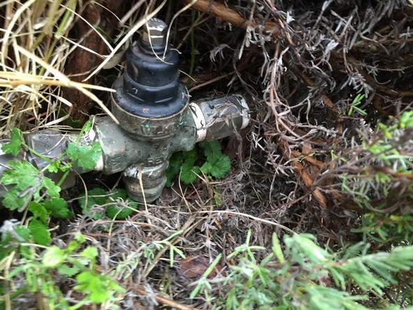

p.s. What is this gadget, in the 3rd pic, at the water meter?
Rough guess but looks like a pressure reducing valve or a one way valve that's been "modified/repaired" by someone other than the manufacturer....most probably a one way valve. The stainless steel bolt and nut on the top definitely looks like something I'd bodgy up.
