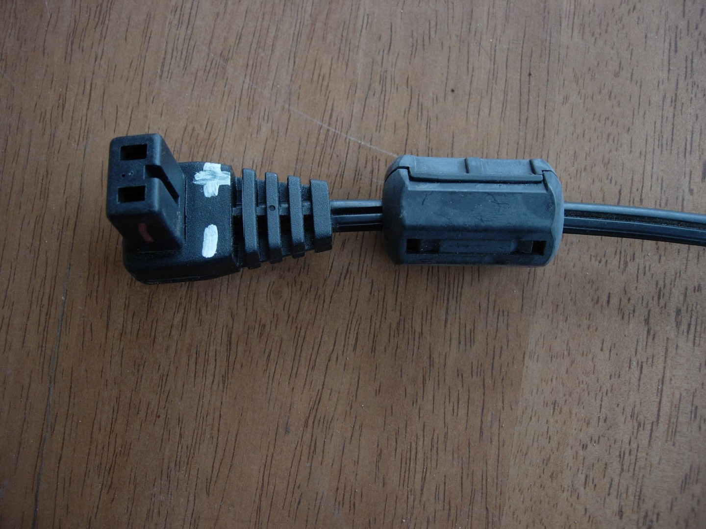

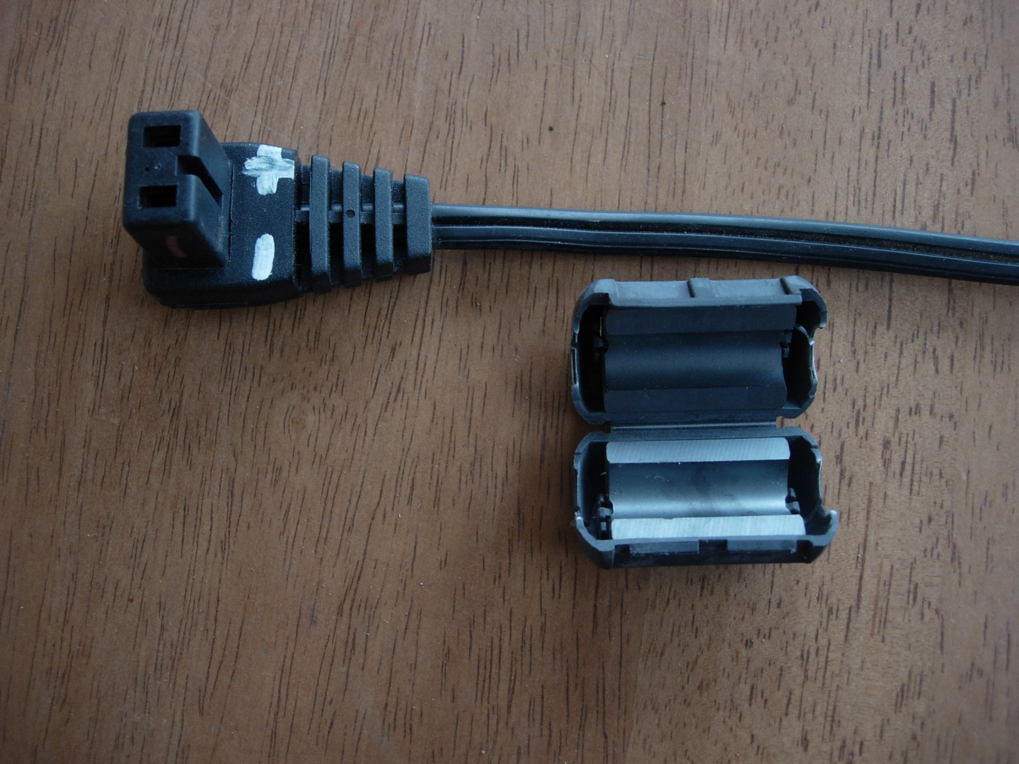

You may try one or 2 of these Ferite suppressor sleeves on the 12V power cord fitted close to the fridge. They are available from Jaycar in a pack of 4 LF-1292.

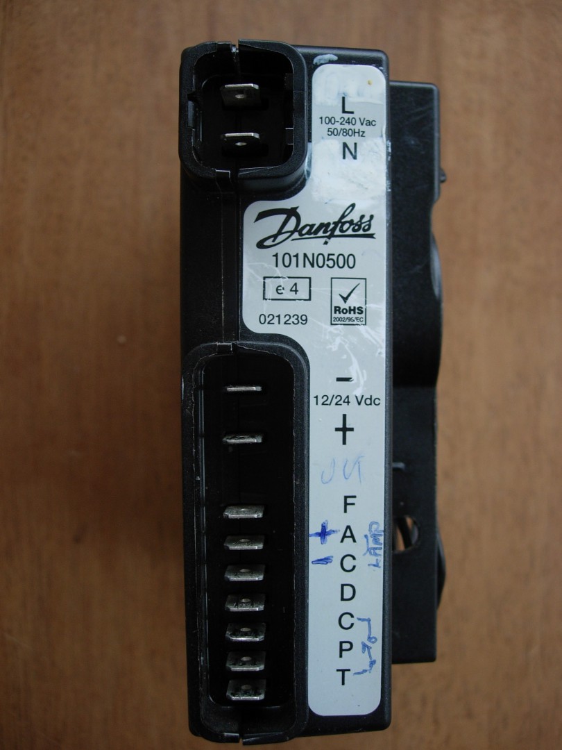

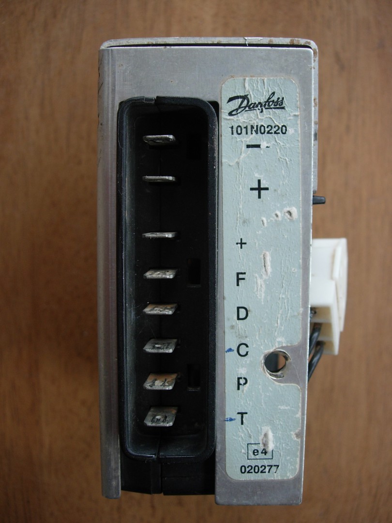

Theres 2 types of Danfoss compressor controlers on Waeco fridges. The 101N0220 should have an aluminium shield on it to supress interference. The 101N0500 is not shielded & has a 240V AC powersupply built in it.
