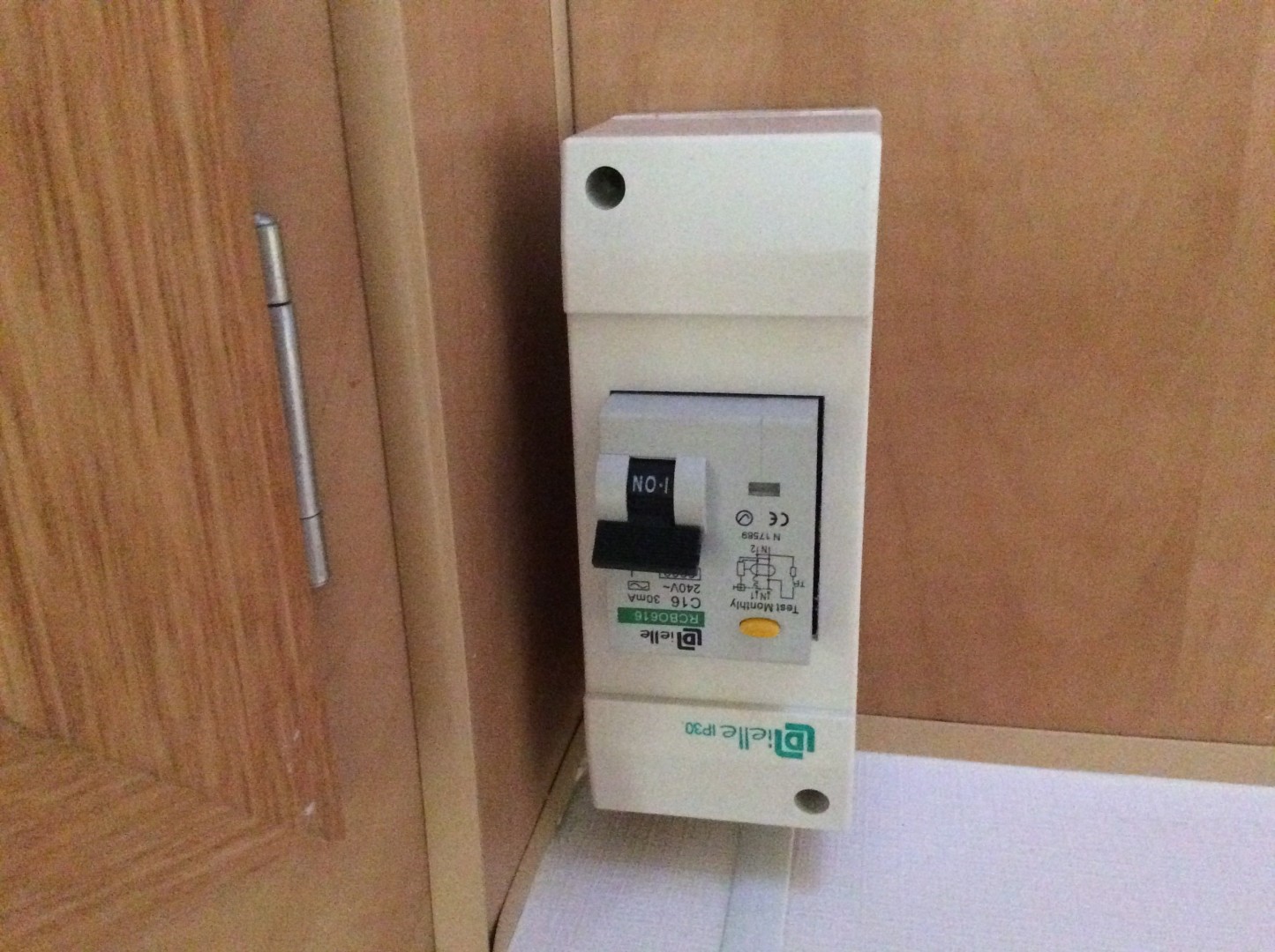

our water pump has stopped working. Asked in techies corner n a reply said to check fuses. The only fuses i can find is in the picture. Can anyone tell me is this 240 volt or 12 volt or do i need to keep searching for another fuse. Thanks. Rocket
ps sorry do not know how to turn photo around or make it smaller

No that's a 240 Volt switch. Unfortunately you will have to try and trace the wires starting from the pump backwards.

Sorry, you know me, silly. Seriously though, you asked if that was 240v or 12v in the pic. It is 240v and if you look just below the switch it actually is printed there as well.
As to the 12v fuses, check near the chargers for the battery first. Then find where the cable comes into the van from the front. If you have a boot or tunnel, start there. Sometimes these van sparkies put them in strange or hard to get at spots for some reason.

Also Rocket that switch box looks like it is the main switch for the caravan has it has got 240 volts on it the house pump would be 12 volt
