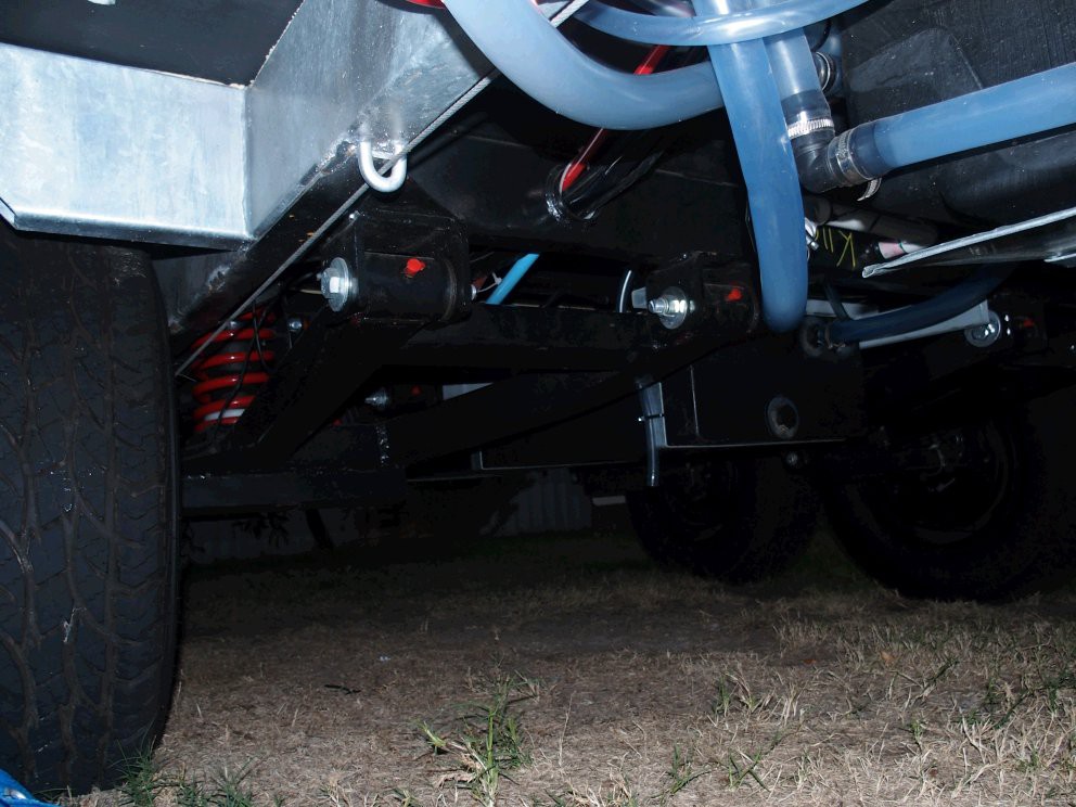

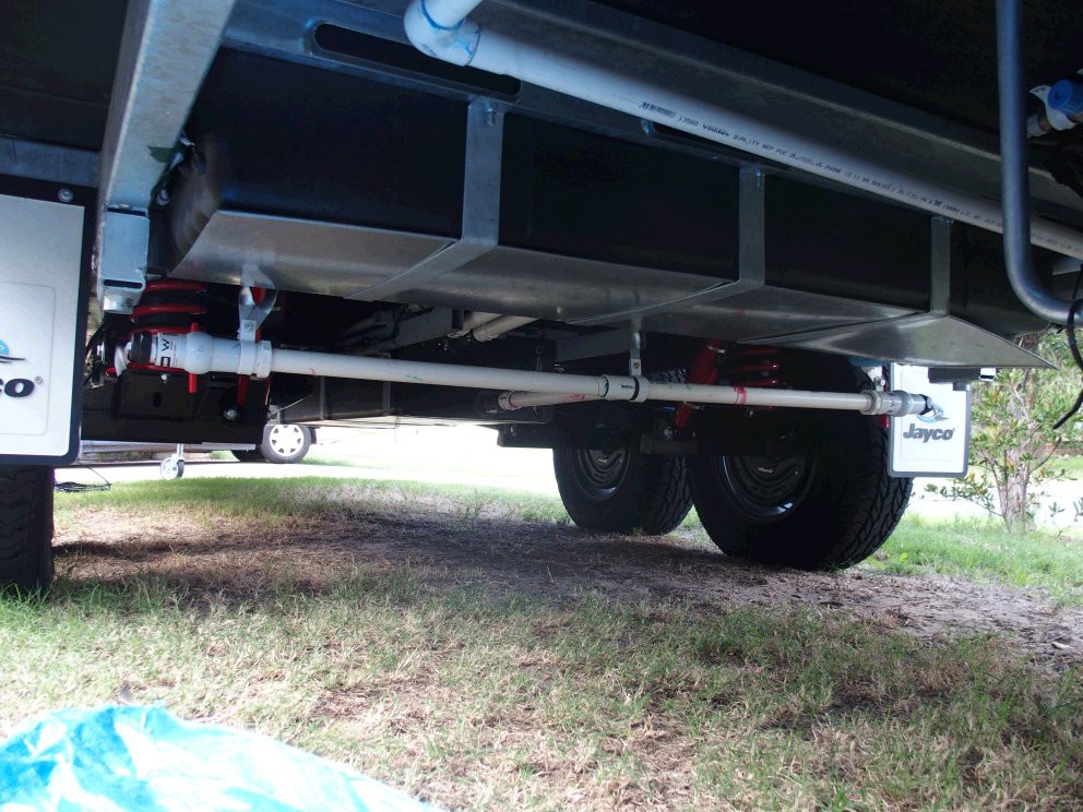

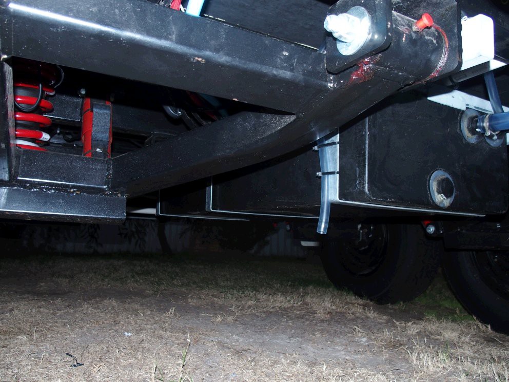

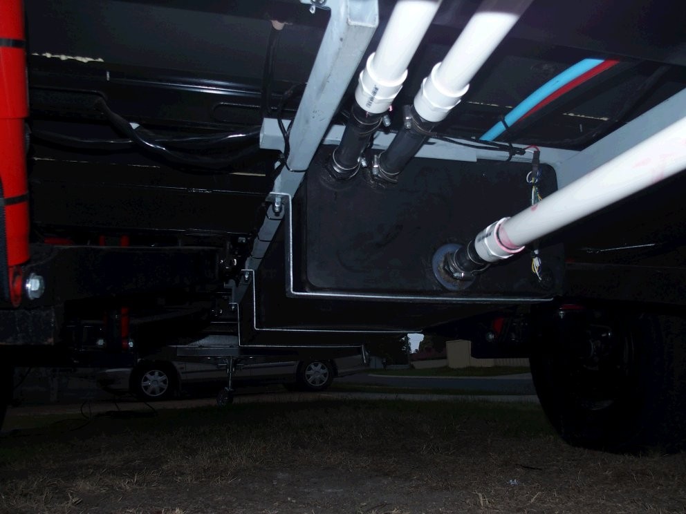

I have finally finished repositioning my grey water tank, The tank originally was mounted where the rear water tank is meant to be, and that water tank was installed way up front, which really up set the ball weights when filled up.
Now everything is positioned about the suspension and the ball weight is sweet. The grey water tank is mounted between the suspension wish bones, I have even incorporated "Hey Jims" LH/RH outlet system.

That praise needs to be given to "Hey Jim", I put the problem up on the forum, and he came up with that suggestion.
Dougewe, I did end up with a hospital trip when I got a drop of glue in my eye from that tubing, but no blood.
The whole lot is held up by 6 bolts, (lock wired) so its not a huge drama to work on the suspension arms when the time ever is required.
Wiring and sensors all fit and work.
