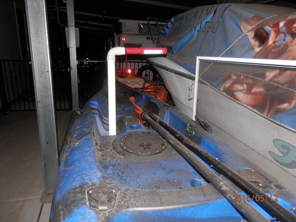

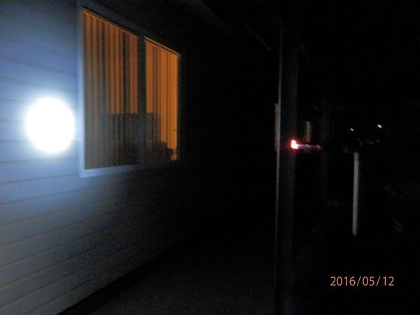

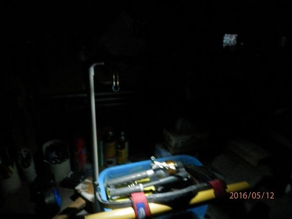

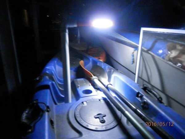

This setup is a dual function LED /Beam light fitted to a 40MM storm pipe that is made like a sand spike The torch came from the Reject Shop, has a neat 40MM base so if making one make sure you have a small piece of 40MM to reduce the elbow back to a neat 40mm.
I also found I had a 20mm based torch and does the same thing for the ****pit of the yak but no beam function for shoreline distance judgement but I'm still looking so I can go small with both function for Yak and Beach

That light of yours would be good for squidding. Swing it out over side of kayak.
