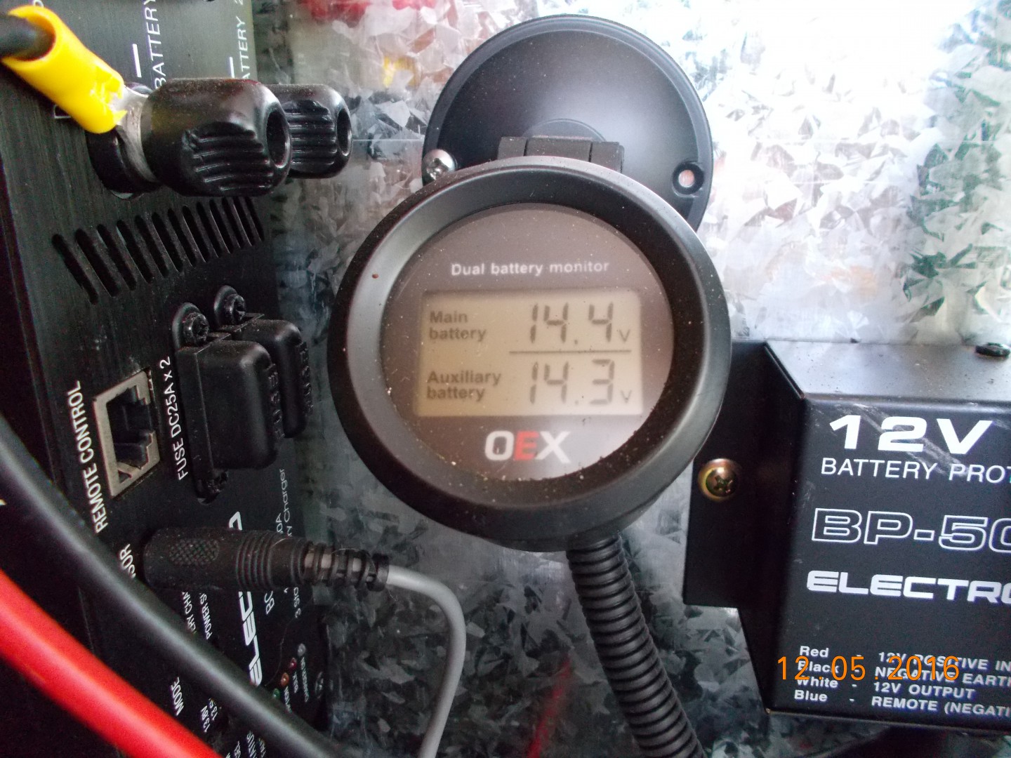

Firstly, did you check the voltage at the battery before disconnecting it? If the chargers have been on for an extended period, they should have backed off and maintained a voltage of around 13.4 - 13.6. If the voltage is higher, then there is definitely a problem.
Are the chargers multi stage with float capability? If not, then that may be the problem. Do your chargers have the capability to choose battery type? If so, make sure the settings are correct. If you don't know your battery type, choose Gel as that is the lowest voltage setting.

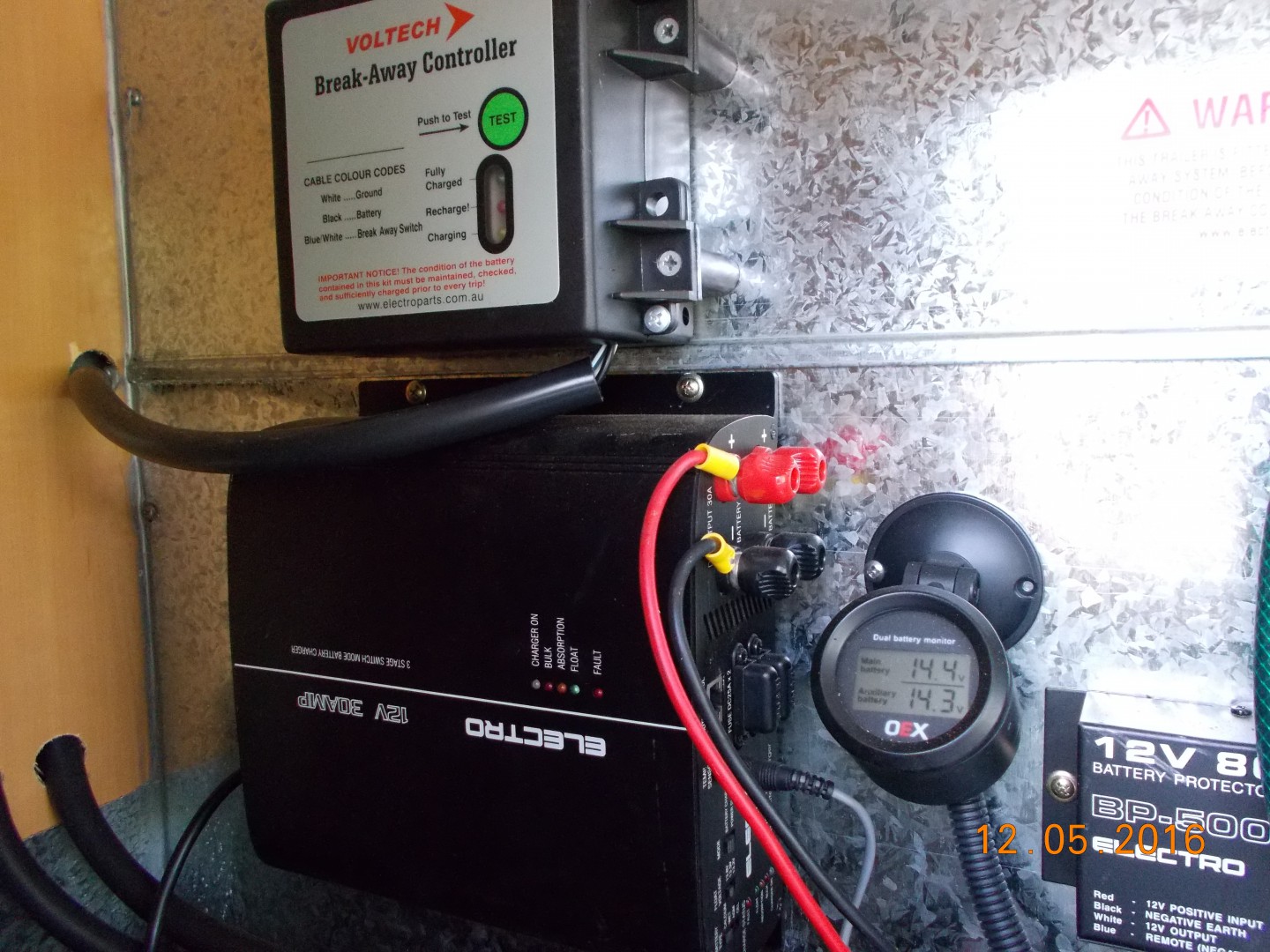

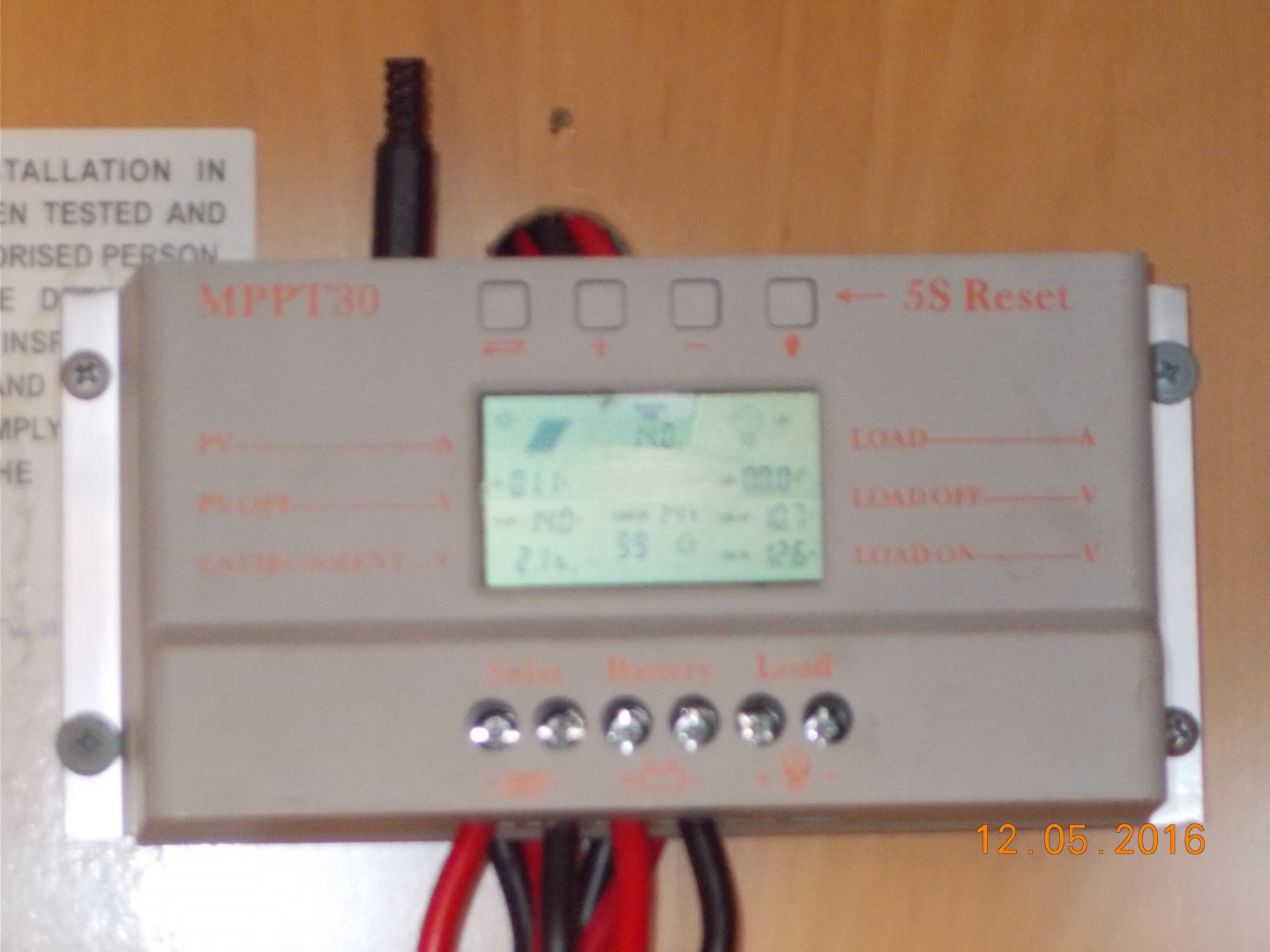

These are a few fotos of my settup in the van ,240 v power has been turned off only using solar panels now .Foto 1 shows battery charge state ,foto 2 shows pwm charge controller ,foto 3 shows 3 stage battery charger .
Sulphur smell says to me that you are using a lead acid battery, having had a near fire involving one of those there is no way that I would ever have one in the van. Get a sealed gel battery. You will pay more but what is that compared to peace of mind??
