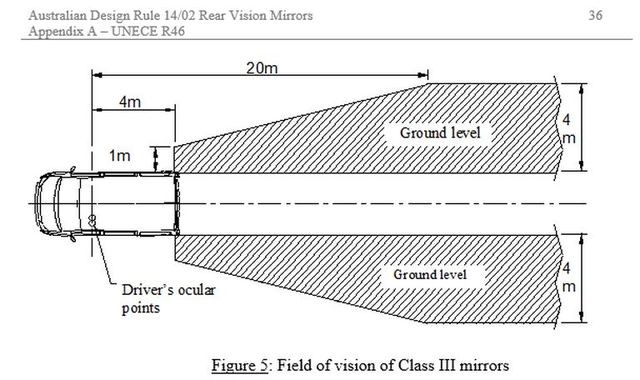

As I understand it the Australian road rules require a driver to be able to see traffic behind and to the side "by Reflection" so if the trailer you are towing is wider than the mirrors on the towing vehicle then mirrors are required.
This diagram gives the view required by ADR 14
Australian road rule 297 also has a requirement. see it here: http://www.austlii.edu.au/au/legis/sa/consol_reg/arr210/s297.html

Yep, regardless you still have to have the rear view mirrors covering an arc of view on each side.

My reading of the current ADR 14/02 2006 covering rear vision devices does allow for camera/monitor devices to replace mirrors. The only problem is they must be tested against the standard and marked with an approval No. to be legal. Although I don't know of any manufacturer who has gone through the approval process they are increasingly used in the trucking industry so there now may be some that are approved.
