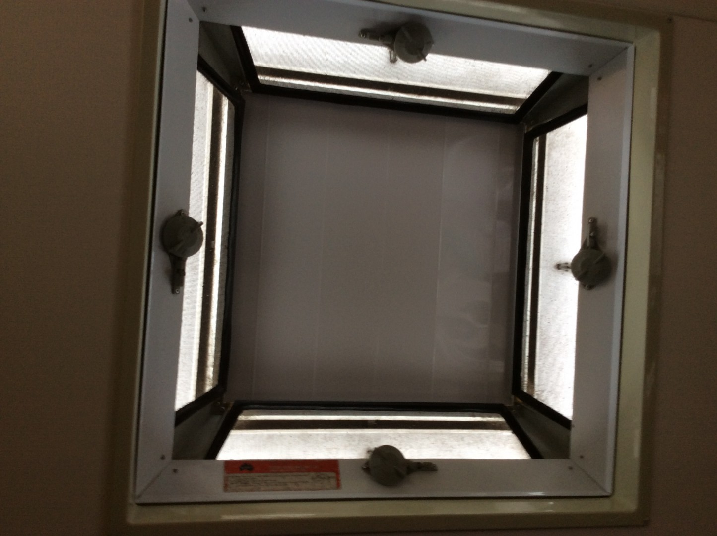

hello everyone, i am cleaning the hatch on ceiling and screens but how do i clean the outside parts that open up. Can i somehow remove the screen gauze or do i need to get on the outside roof? Thanks. Rocket n strop

hi tony bev, we have a supreme territory caravan n hatchs, there r 4, open out

hi delta 18, thankyou, that is interesting but mine does not have any latchs to unclip.
07:50 PM May 2, 2016
The hatch you have is a Camec Four Seasons hatch. As you can see from that link you can get replacement screens for them so they must come out easily. Try prising them out with a screwdriver or knife.

Exactly.
Mine have mini screens that fit in place just like the window screens with a flexible ribbed 'rubber' edge.
I just use a paddle pop stick that has been sharpened a bit.
