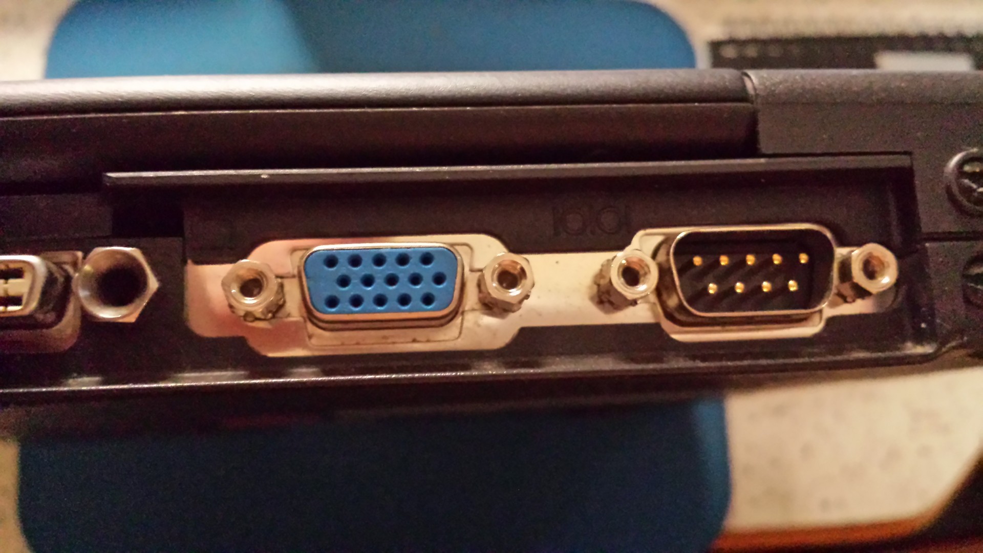

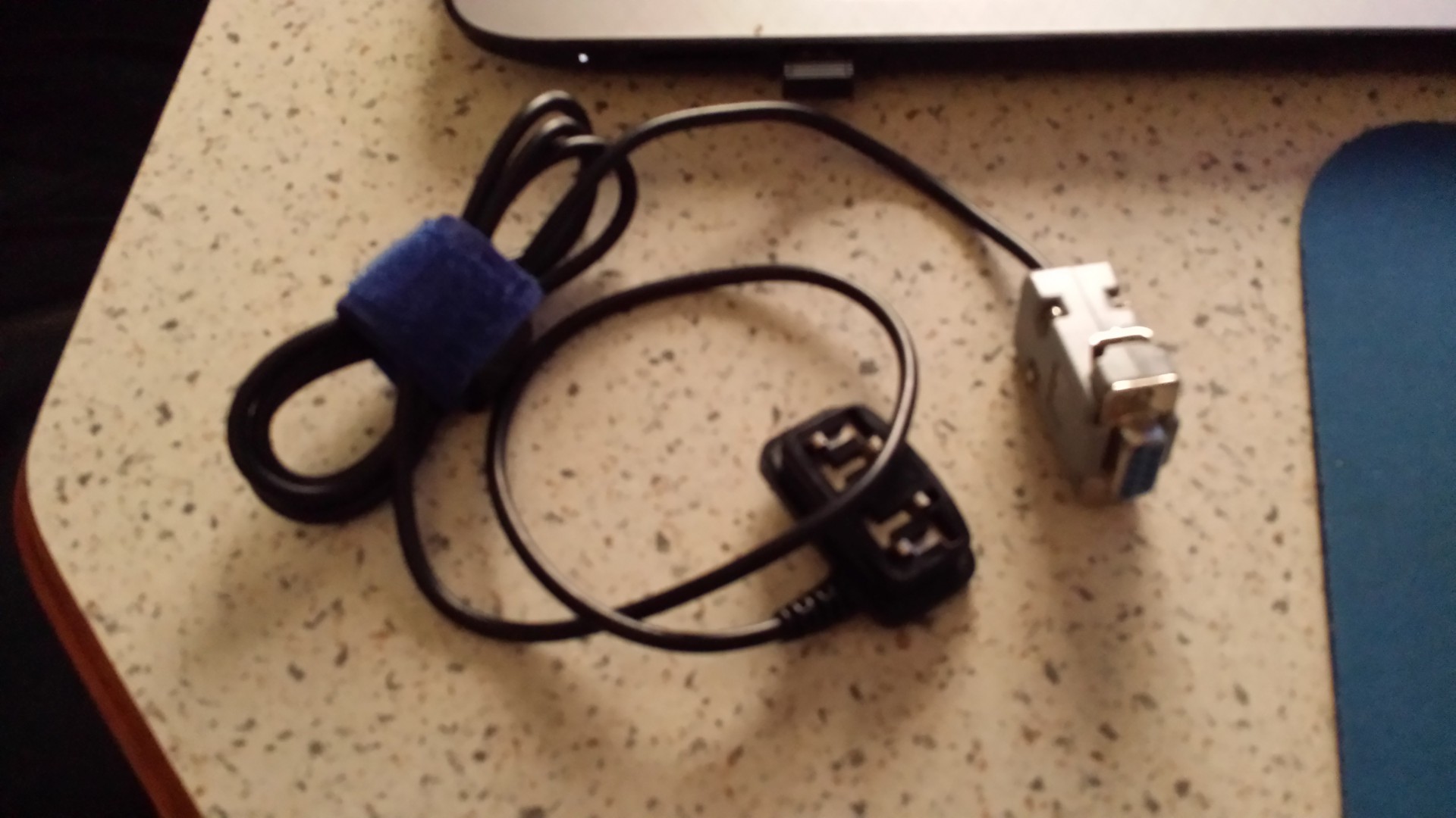

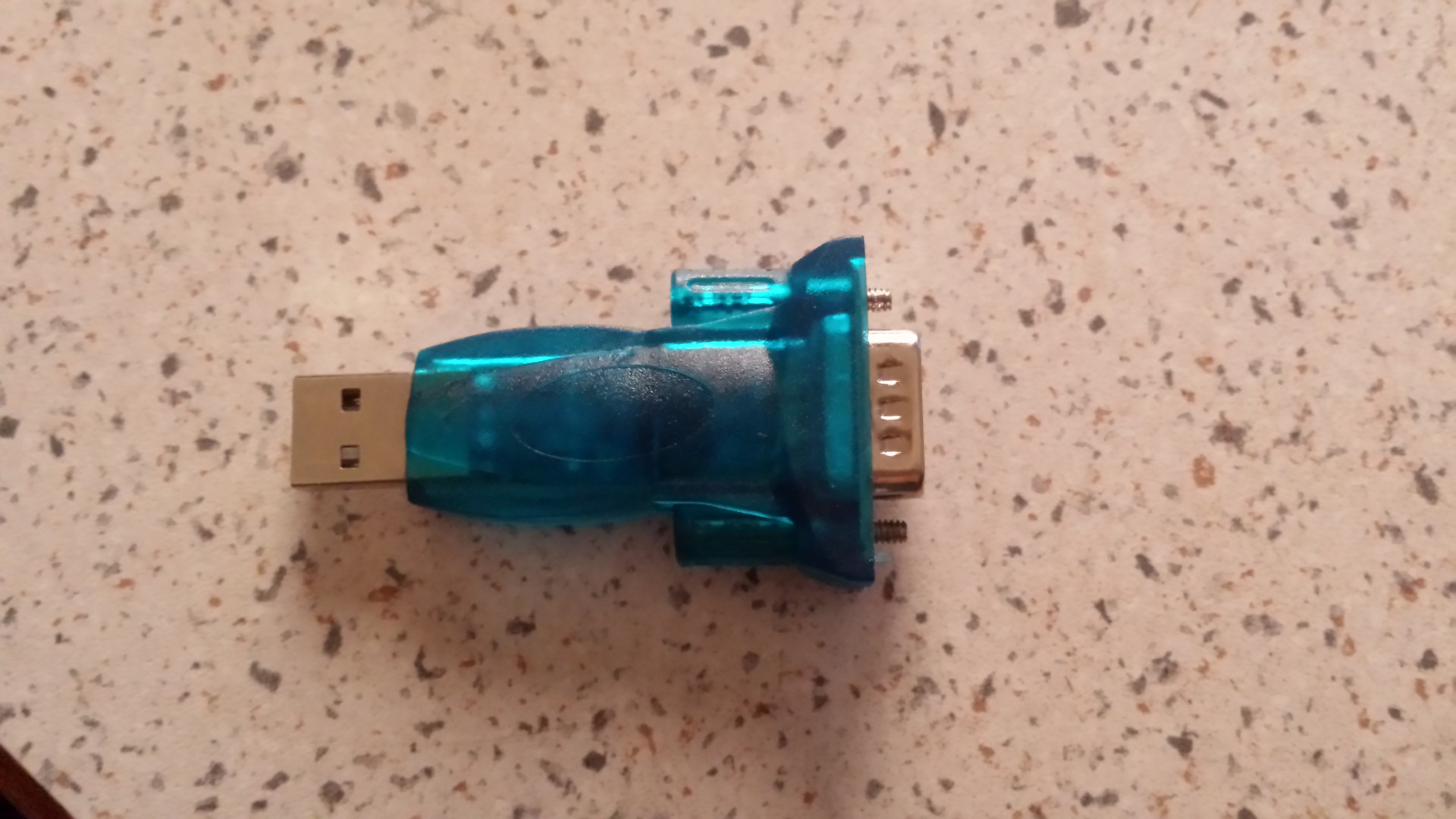

Doddo said
11:54 AM Apr 27, 2016
My GPS is NEMA compliant and it's connected with a nine pin plug.
Have identified adapter as CH340 VID 1a86 have not been able to identify safe site for driver download.
Will take photo's to help.
thanks.
-- Edited by Doddo on Wednesday 27th of April 2016 12:23:52 PM
-- Edited by Doddo on Wednesday 27th of April 2016 12:27:12 PM
-- Edited by Doddo on Wednesday 27th of April 2016 12:28:33 PM
FWIW, I found a Microsoft tech note that states that Windows 10 incorporates native support (Usbser.sys) for those USB-serial devices that comply with the "USB communications device class (or USB CDC) specification".
Perhaps the CH340 is one of these? I would look in Device Manager for a likely Port, then examine its Properties. Maybe it's already there.
The adapter appears to be the +/-12V type, in which case the physical interface would be compatible with your GPS. You could perform a loopback test (with PuTTY) by shorting pins 2 and 3 (Tx and Rx) with a bent paperclip or similar. I have an ancient Uniden GPS with a similar interface and I recall using it with HyperTerminal through a standard COM port.
thanks.
Google popped this up at the top of the list. Dunno how secure and safe the site is, but there are a heap more results to choose from.
Driver
https://msdn.microsoft.com/en-us/library/windows/hardware/dn707976(v%3Dvs.85).aspx
