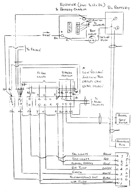

Cupie said
11:14 AM Apr 25, 2016
RE the wiring diagram issue ..
Like others I could not get a wiring diagram from Jayco.
One day while inspecting the underside of the van I came across a rats nest of wires 'protected' from the elements by a flimsy L shaped piece of Galv Iron sheet.
So I commenced the task of cleaning up the mess & putting it in a large electrical junction box screwed to the underside of the van floor.
To complete the job I traced all the wiring & drew up my own rough wiring diagram. A copy is now taped to the power supply box & another inside the electrical junction box.
A copy is attached. Perhaps I should tidy it up. One day maybe.
Back to the original post. You can see from my diagram that the Andersen plug goes straight to the in house battery that has a feed to the fridge (12v switch). The 7 pin plug term2 (Aux batt) also goes to the fridge.
